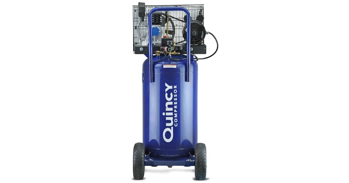

Anyway, I was looking at what Napa has and I think this Napa compressor is the same Quincy that is often talked about in other threads. Both made by Atlas Copco and 7.4acfm @ 90 psi. Except the Napa version is grey instead of blue and is $450 instead of $700.
vs the Quincy
AVOID-
My brother bought this exact unit (Qunicy), its a turd. Lots of quality issues, def can find better unit out there.

I've searched the forums and the only real negatives I've seen for the Quincy are that it's over priced and from the same person saying their brother was not impressed in multiple threads.
I called my local Napa and they told me they could order the compressor and have it in store for pickup mid-week since it's a holiday weekend.
I did see some reference to the HF 29 gallon compressor using the same pump as the Quincy. It has a lower CFM rating, but is less expensive even and available at some local stores, but not mine.
Honestly, I think I'm leaning towards the Napa compressor. I just need to decide what Napa I want to pick it up from as my work schedule won't allow me to get to the nearest Napa to my house until Friday at the earliest. I'm helping out together a suicide prevention/overdose awareness candlelight vigil this week after work.

Well, I decided to give the Napa a go. 24gal 7.1 CFM @90psi should be a decent improvement from what I had before. Unfortunately, with the holiday weekend I probably won't be able to get it until end of the week, but that's alright. I can report when I get it.
GeoBruin
May 5, 2018
3,754
The Harbor freight is not the same pump. It's very close, but not exactly the same.
I think you're going to be happy. The version you bought from Napa is actually the older version which in my estimation is the better version.
It's the best bang for the buck in the "reduced footprint" arena and I verified the current draw and cfm (with a flow meter) on that Quincy.
Good luck!

got my new compressor yesterday after work. 😎 it looks like the current version of the Quincy since it is 24gal instead of the older 26. It is way quieter than my old one, but still decently loud. I’ll have to find a piece of tubing to add to the intake. I didn’t have a piece with a large enough ID to try it last night. I’m hoping it holds air well. My old one would leak slowly from the compressor head and run more frequently than it needed too. I left it off and pressured up last night and will check when I head out to the garage later this morning.
tarbellb
Apr 17, 2011
5,794
Oregon
Keep us posted, interested to see how it performs and holds up.
Any insight to where the components are made?
S
soloz2
Jun 30, 2012
864
Western NY
Looks like it is made in China.
The motor is prewired for 110v, but can be configured for 230v. It says made in China and continuous duty.
I can't find anything specific on the pump. it does get warm when compressing air, but all compressors get warm. The belt does move enough air to keep air movement over the fins. It does have some intake noise so I'll have to find a cheap piece of 3/4" ID tubing to see if that helps.
I let it sit with the power off and it didn't lose any air for 48 hours so that's a good thing!
I free spun my impact and the cheap HF die grinder I just picked up for a minute or two and the compressor seems to cycle well. It doesn't take nearly as long to pump back up as my old one did so that's a plus as well.
I ordered some PEX connectors and am going to run an airline or two across my garage. I also picked up a pack of Milton V style connectors and they flow so much better... But now I need a ton more... So not sure that was really a "good" buy. 😂 I found some Amazon Basics that don't cost as much so I might give those a try, or just pony up for some more Milton ones.
