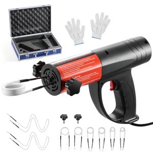

I am thinking of investing in one of these types of heaters. I estimate my use down to a about 6 to 10 times a year. Not heavy use. I am thinking of the Vevor 1500 or 1100 watt, or the Solaray 1100 watt. I am concerned the 1500 watt or higher may trip the breaker. On the Vevor, the coil leads look shorter. Maybe they are not, but it kinds looks like they are and that may make it harder to use in some locations.
Anyone have experience with the Vevor products?
Bmw4life
Apr 17, 2020
207
Canada
I dont have any experience but my buddy had no luck with 1100w. I would not go below 1500w. It shouldn't trip the breaker. What you really want is a tool that works, and you don't have to waste your time and money and be frustrated.
At 1800 watts and 120volts you are pulling 15amps. If you are on a 20 amp circuit, not a problem. If a 15 amp circuit, you have a problem. The cheaper ($500) Induction Innovations does not provide a wattage or current draw on their website. All I can find is voltage. The other two brands mentioned above have 1800 and 1100 watt units. Sure, I want it to work well, but if it keeps tripping the breaker, is it working?
Bmw4life
Apr 17, 2020
207
Canada
Go for 1800w. Mine is 15 amp and didn't trip the breaker. Just don't load anything on that breaker while using the heater.
You'll only use it for a couple of minutes here and there. It's not like it's "on" for an hour and the breaker keeps tripping.
Get 1800w you won't regret it

I have one of the cheaper knockoffs, a “hot rod” or something like that, and it works well but is slow. The name brand ones are much faster.
All that to say - if you’re going to get one of the knock offs get the 1500w at least.
