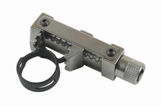

Anyone tried this type that you use with a ratchet/extension? They look like a good simple design with less to go wrong than the cable type but not sure you could get into as tight places.

Another option is vice grip style locking hose clamp plier. Gearwrench used to make some, but I think they discontinued them. Other companies still make that style though. They also make slip joints pliers w/ the same type of jaw as those locking ones as well. AE92 or AE932(newer model of the AE92 I think) from KTC is one Japanese made example.
The ktc pliers: http://www.thetoolnetwork.com/ktc_ae92_clip_pliers.html

I have the cable type from Astro, and the KTC AE921. I like them both and select one mostly depending on the space I have to work with. The KTC AE921 is small and works with any 3/8 drive device, it really clamps down well. The Astro cable type has the cable obviously which you don't want to bend too much or deform..that can be an issue depending on the space.
am also looking to get the KTC AE932....sometimes the AE921 can twist a bit on high torque situations...am thinking the AE932 would avoid that.
