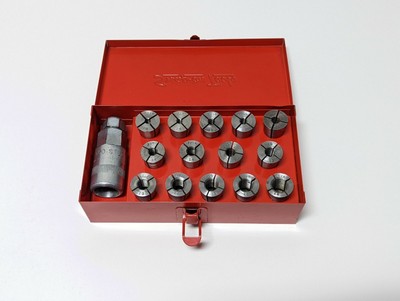

Fairly often I find myself removing studs, whether it's from an automotive engine or something smaller (chainsaw). Some SAE, some metric. I usually just use doubled up nuts to remove the stud, but that can be a sub-optimal method and lead to broken studs.
There seem to be a few different types of extractors out there and I was hoping someone with experience could chime in with a recommendation.

I have only used this type from OTC. It worked perfectly on exhaust manifold studs.

I’m in need of a good solution as well. Sometimes doubling up nuts on there doesn’t work, and the cam type are too large. Leaning towards picking up a Snap-on set.

All the above are great except the "old school ones". If you do not have room for them, try this, take a coupling nut in the same thread, screw a set screw into it, screw it on the stud, then tighten up the set screw, and back out the stud, this will work unless the stud is locktighted in or really stuck. Then use the same trick and heat. The old school ones put a sideways torque on the stud and can bend or break the stud.

I've used a set offered by Snap On that acts like collets on the stud thread. Luckily, someone else paid for them.
These do look nice, but my budget can't handle the going rate of $375 for a set right now. I'll add it to my wish list.

I want the ABN, socket-style set, but after watching the video, it looks like the stud wouldn't be able to be reused with that style of extractor. Too much damage to the threads. The ones that look like a drill chuck looks like you could clean the threads up with a die and reuse the stud. Might be something to think about:

In my experience, ATC, the drill chuck one will actually chew up the threads more (to the point where they are no longer usable). However, you are correct that the socket type does mash the threads a little.
When I was in A&P school, one of my instructors had a Mac tools version of the ABN socket stud remover. The threads usually were damaged after removal, but he would always chase them with his thread chaser (This set to be exact:https://www.amazon.com/dp/B000P6UNHE/?tag=atomicindus08-20 ) and the threads would work fine again. Obviosuly, there is a limit to how many times you can do this before the stud threads are totally ka-put.

I use the roller socket style stud pullers mostly (on good studs that aren't seized), if your dealing with corroded and seized studs your not going to beat oxy/acetylene or a mig welder or maybe even an inductor type tool.
They are more of a technicians time saver than a "get outta jail free" type tool to be honest, if you need to strip a cylinder head for skimming they are useful.

If I'm dealing with something that's corroded and seized, I'll certainly hit it with the torch first. I just like the fact that these removers support a longer length of stud than you'll get when using two nuts to remove it. Seems to make it less likely that you'll snap it.
