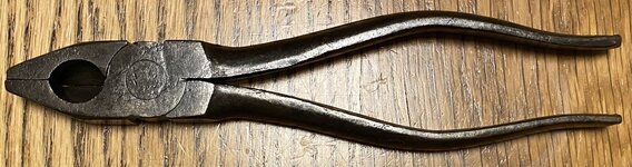

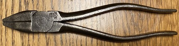

I found another pair of Red Devil 1950 Lineman’s pliers on Friday like the pair that Tin Medic showed in the first post of this thread. The markings look different than the one shown in the catalog but the part number is the same.

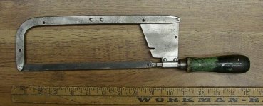

This one definitely caught my attention earlier, and when I remembered who Landon P. Smith was, it made me wonder "how old is this thing?"
Interested in hearing from you gentlemen on this one:
Landon P. Smith No. 22 4-way hacksaw (ebay 194089787997 01).jpgLandon P. Smith No. 22 4-way hacksaw (ebay 194089787997 02).jpgLandon P. Smith No. 22 4-way hacksaw (ebay 194089787997 03).jpg
Landon P. Smith No. 22 4-way hacksaw (ebay 194089787997 04).jpgLandon P. Smith No. 22 4-way hacksaw (ebay 194089787997 05).jpg
( photos courtesy George Roberts )
Seller notes that repairs were effected by the previous owner with common box nails. (More photos posted in the ad for the item: https://www.ebay.com/itm/194089787997 )
Is this the only widget that Mr. Smith was making? Or were there others as well prior to "Smith and Hemenway"?
Smith / Smith & Hemenway Co. Inc., 101 Coit St., Irvington, NJ / "Red Devil" "Never Slip" / http://alloy-artifacts.org/smith-hemenway.html / http://alloy-artifacts.org/smith-hemenway.html#smith-hemenway / https://www.garagejournal.com/forum/showthread.php?t=374811 / https://www.garagejournal.com/forum/showpost.php?p=8700232&postcount=23 /
Smith / Landon P. Smith Inc., Irvington, NJ / hacksaw /

I don’t think the saw is as old as you may be thinking. Landon P. Smith Inc existed 1926-1945, before the name changed to Red Devil under Smith’s son-in-law, George Ludlow Lee, Sr. Not prior to, but after Smith & Hemmenway.
Lee was a noted stamp collector, too. Born 1901. Died 1966.
