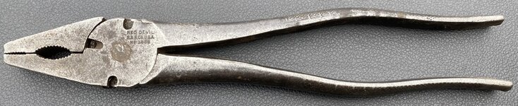

I was very excited to find these at the flea market yesterday. Another combination approach with the Button's pattern cutters, but pipe jaws, a square smooth opening, and then gripping jaws at the tip.
The marking is extremely worn down. The RED DEVIL is legible, the S&H on the second line is barely legible, and just enough of the P/N on the third line is showing to confirm them as a No. 999, and the first example on the thread as far as I can tell.
They are very heavy in the hand and noticeably bulkier than any other in my collection.
The S&H cat excerpt, from 1922, and the Crescent, from 1926, help explain the diverse utilities of the design as well as the unusual massiveness.

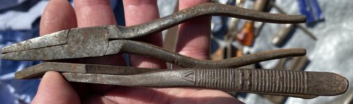

I was elated to find these 8" lineman's pliers at the flea market this morning.
I'm pretty sure the "S.C." marking with the redundant "U.S.A." is martial and Signal Corps proprietary. The "TL-" part number markings came much later. If you page through WWI-era Signal Corps field manuals and Table of Organization and Equipment there are no part numbers.
This ad is from the back of a commercial book called Military Signal Corps Manual, Major J. Andrew White, Wireless Press, NY (1918), with a dedication to Major General George Squier, Chief Signal Officer, US Army, "whose assistance made this volume possible."
