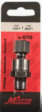

On perhaps a related note, have any of you used the Milton S-659 swivel fittings on the end of a hose that sees a lot of air tool use?
I'm going to try one on this new hose. It seems like it might make using an air tool in tight spaces a little easier.

Best thing you can do for the air line is use a whip hose on the air tool if you want a swivel use a full flow type.

To what 90* strain are you referring?
[/URL]
Mark
The strain is on the hose carcass, where the constant weight of the hose coming straight out of the connection puts a strain on the hose inner tube and outer jacket, right at the highest stress point fo the hose at the end of shell crimp. A 90 at the hose connection lets the hose hang straight down, reducing the stress on the inner tube and cover. That constant stress, along with heat and ozone aging causes the cover to bcome brittle and crack, and eventually the inner tube will do likewise. When a hose end is crimped onto a hose, the crimp action compresses the hose wall, and even causes a slight bulge of the inner tube at the end of the hose end ******. When a constant stress load is added to the hose, it pulls the outer side of the hose cover and constantly works on that buldge on the inner tube of the hose. Over time one or both will age and fail, just like your picture shown at the start of this thread.
This applies for low pressure hose like an air hose as much as hydraulic hose at 1500, 3000, or 5000 psi and above. Even the hose connecting the clothes washer to the hot and cold house connections. Don't stress the hose by causing the weight of the hose to hang bent at the connection.
This is also why some hoses are made with a strain relief collar that is put on the hose end and onto the hose to spread the strain out into the free length/non-crimped area of the hose.

I think he said earlier it's on a hose reel.
