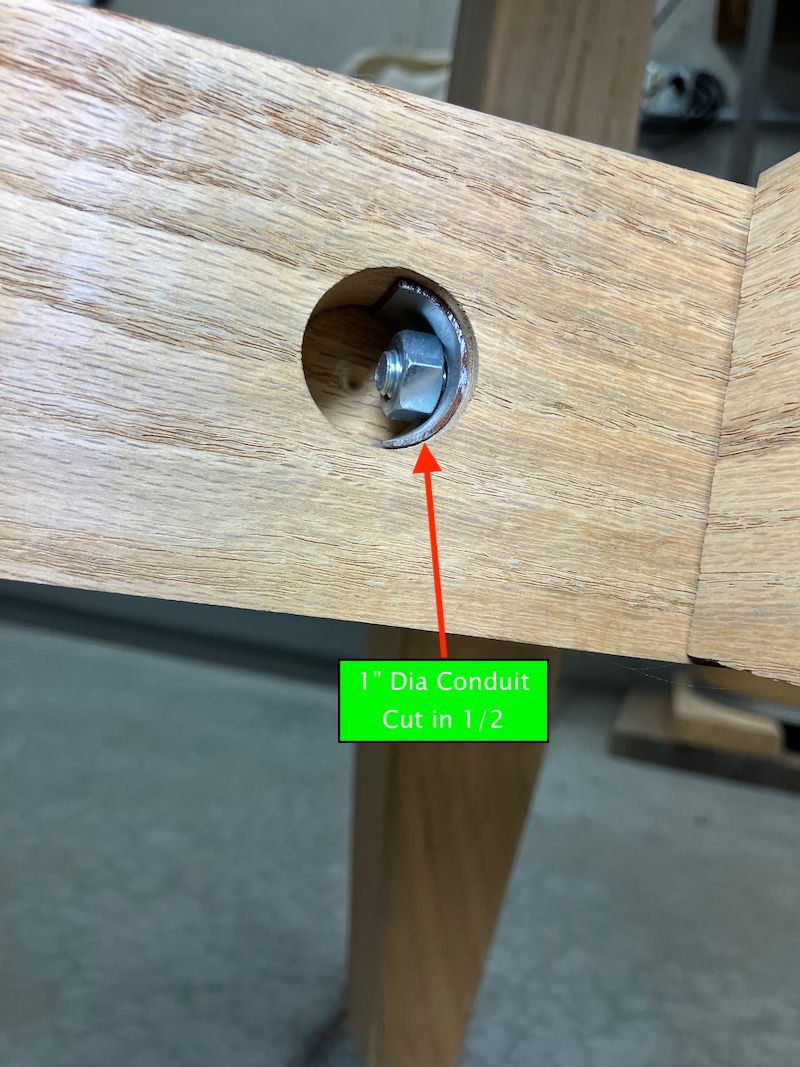

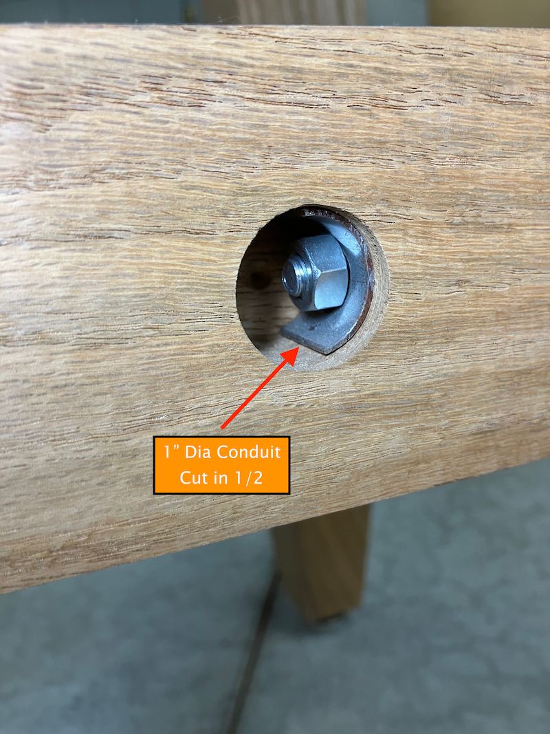

How do you bolt the legs of the bench when you're going into the end grain of a 2 X 4? This is another bench I built 20 + years ago and in this case the end grain of the 2 X 4 is actually the stretcher on the base for the legs but it's the same construction detail. We're talking about the nut that appears to be inside the hole in the 2 X 4 here in the center of the picture.
Here the bolt is going through what would be the leg on my shop benches into the end grain of the 2 X 4. How do you secure the nut end of it?
Look at the end of the bench and the short 2 X 4's ( one on top, another on the bottom )There are 2 holes in each of these short 2 X 4.
Drill a 1" hole in the side of the 2 X 4. Take a piece of electrical conduit which is just 1" diameter thin wall pipe. Cut it the width of the 2 X 4 so when you insert it in the hole you just drilled it won't stick out past the sides of the 2 X 4. Take that piece of conduit and cut it in haft to make a semi-circle.
https://hosting.photobucket.com/images/u288/BB767/Conduit2_c99cjHN3NcLURMA1XPqjU2.jpg
See how the conduit goes just past the top and bottom of the nut, it's now a haft circle. Drill a hole in the conduit so the leg bolt can be inserted through it and then tread the nut onto the bolt. Now when you tighten up the nut it doesn't crush the nut into the end grain of the 2 X 4 and maybe splitting the 2 X 4. By placing the piece of conduit into the hole, it acts as a washer the same profile as the hole in the 2 X 4 and spreads out the surface area of the nut. You can now make that nut much tighter without possibly splitting the 2 X 4.
This is the other side of the 2 X 4. Since I didn't enclose the base of this bench I didn't bore the 1" hole in the 2 X 4 all the way through like I did on the shop benches. That's because this side is exposed in front of the bench and I didn't want the hole or nut seen. Purely for aesthetics.
I just used electrical conduit because everybody always has a short piece of it floating around their shop and it's a cheap and easy detail to fabricate and gives good results. Cheap and easy, two endearing words when it comes to building something!
Hopefully all of this will help......... but if not drop me a PM and I'll go into greater detail. Thanks for keeping me on my toes!
