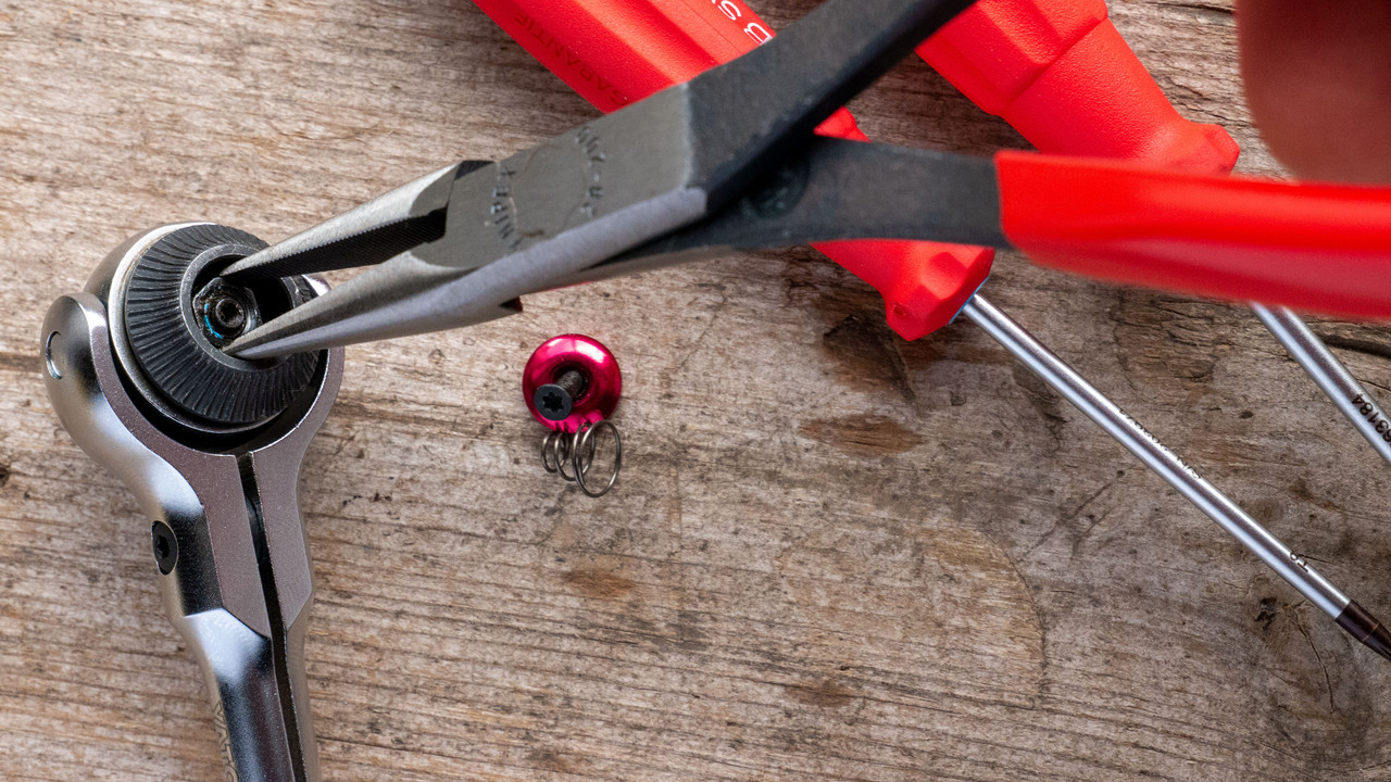

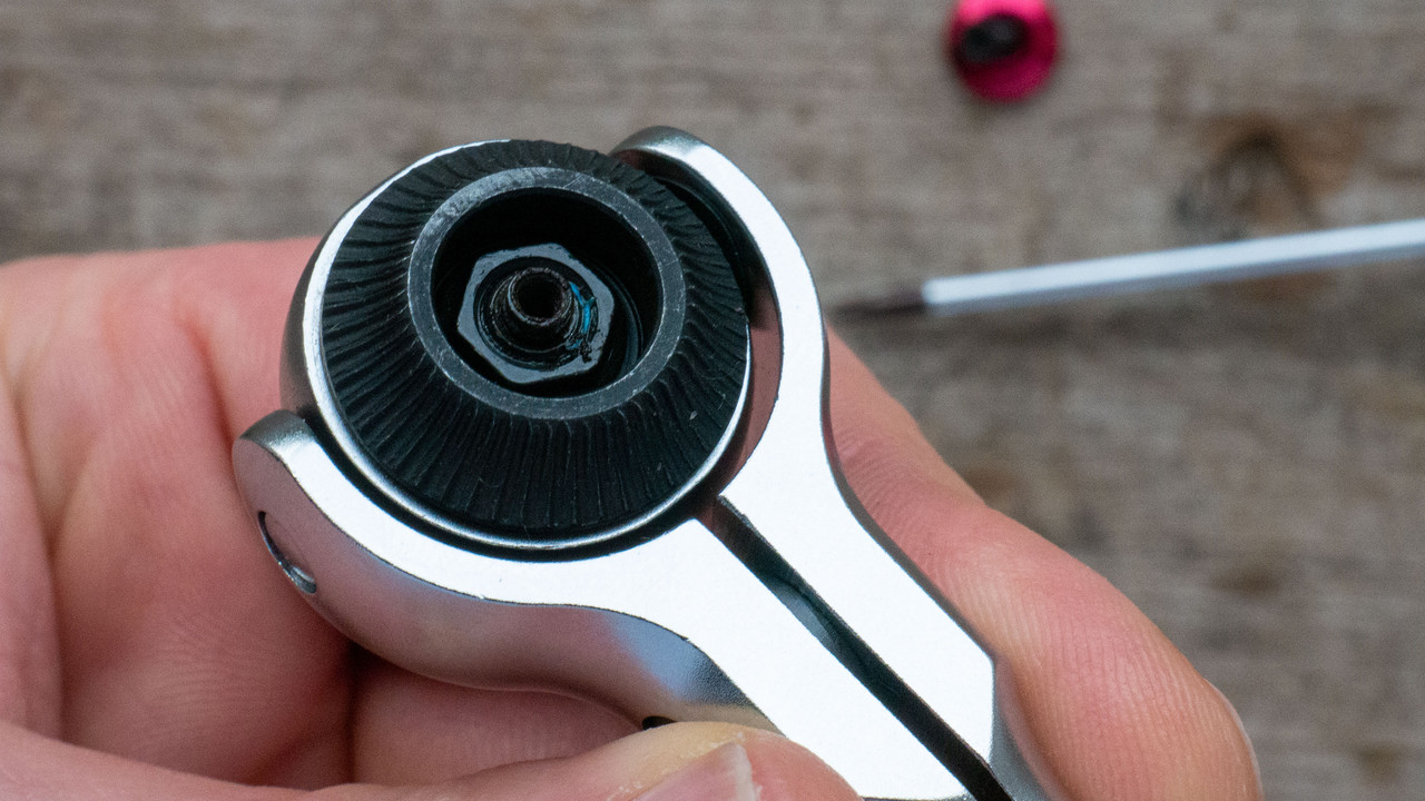

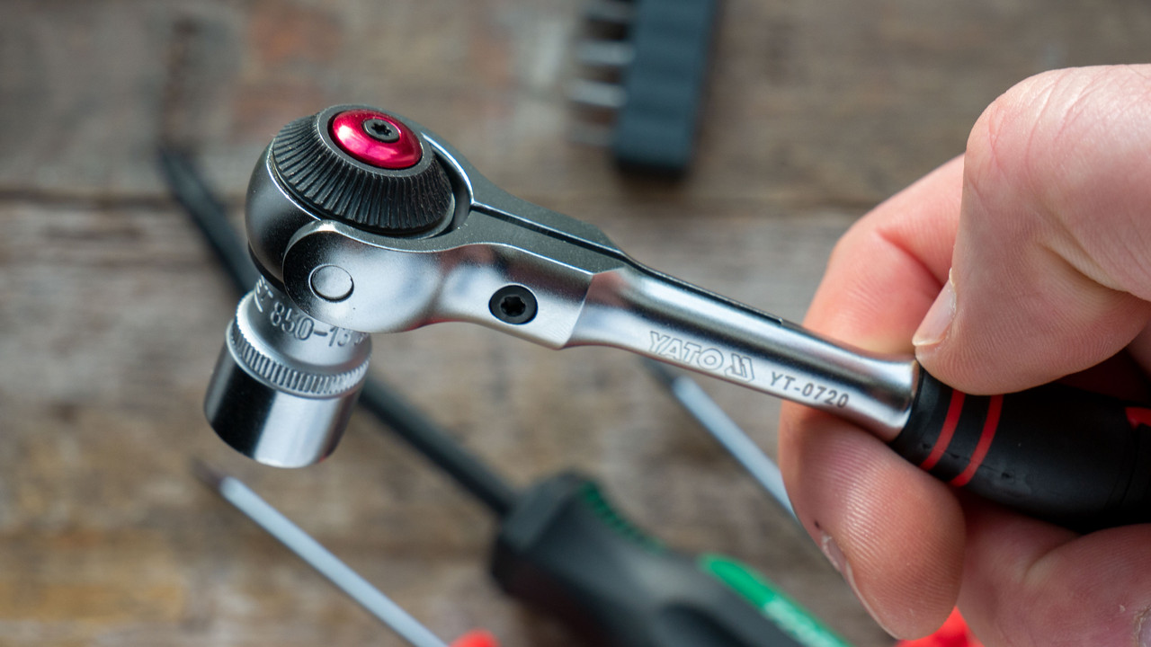

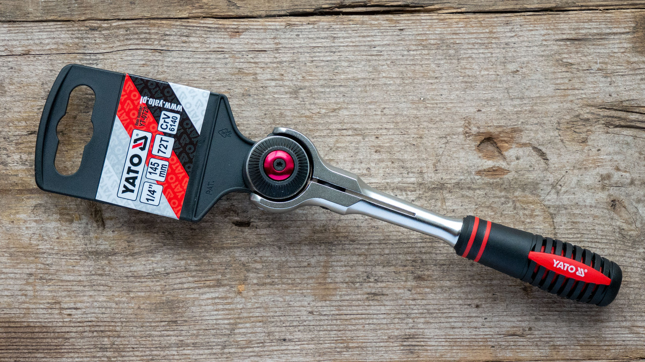

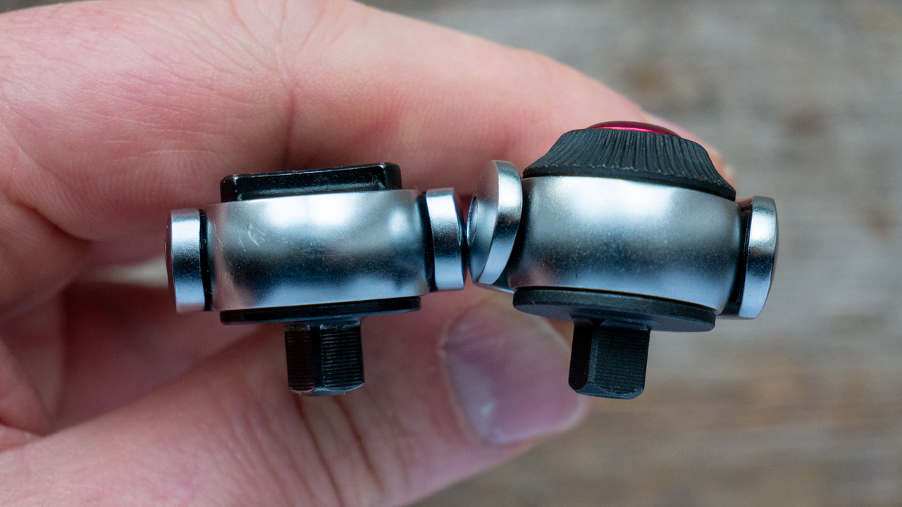

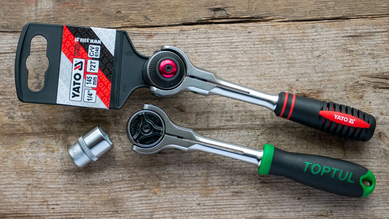

Picked up a Yato roto ratchet as I wanted to try a roto with quick release after seeing the Vessel rotos. Yato was the only one I could find in the UK at a reasonable price.
Compared to Toptul (non QR). First thing I noticed is that the head of the Yato is significantly heavier than the toptul which I think throws off the balance. The design of this particular direction change ring is not only heavy but difficult to operate with my thumb.

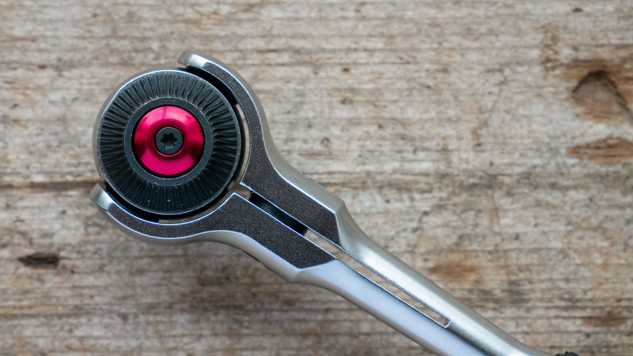

Quick strip down. T8 torx on the QR button.
8mm hex.

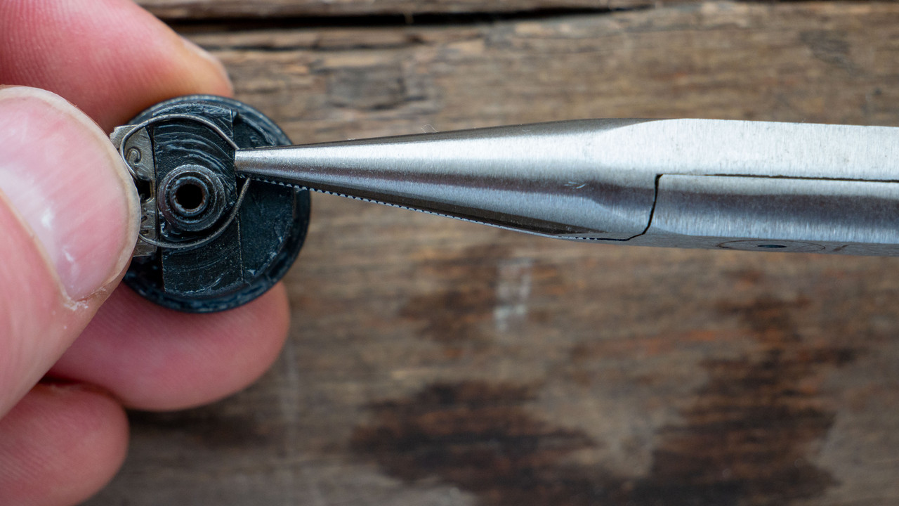

The 8mm hex is recessed and my sockets were too thick so used pliers.
Familiar round head type mechanism. Pulling on spring a little and lubing improved back drag.

laser do QR in UK for about 22GBP .
They basically same ones as tekton and many brands use to have .
only downside on them is not strippable as factory crimped but they solid strong ratchets and same switch style as the toptul ...

On the Yato, the increased depth of the swivel (anvil, pawl and etc. fit in it) seems pointless. If it were no deeper than the TOPTUL, any failure would still almost certainly happen to the anvil - weakened by the hole for the quick release pin. And the directional switching cover looks like it could be a shade less tall also.
That's a nice sequence of pics Mr_B.

yes they QR, older better style has a torx in centre of blue button, newer style has chrome domed button and likely be factory crimped type .
