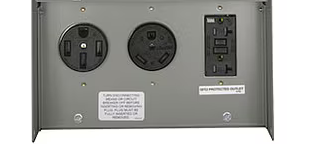

Before calling an electrician, I'm trying to ascertain whether pulling that 240V/50A line to a (Hubbel EV) 14-50 receptacle on the right front home exterior to serve our friends and guests is a worthwhile and practical endeavor, without getting too costly and ridiculous. Would that single outlet power both EV's and most modern RV's/trailers (not at the same time)? Could wires be run through the attic to a receptacle, or would it need to go through the sub-panel first?
A 14-50R on a 50A circuit is about 9.6kW continuous (40A). That's enough to run 2 x 5th wheels with 2 ACs each.
I have a bunch of RV / EV outlets (14-50R). I've probably installed 10 of them total.
These will work for Level 2 chargers, yes. It's the standard outlet type for plug-in level 2 EV charges (EVSEs).
They will not work for a Level 2 charger and a "50A RV" in most cases unless the EV can control it's charge rate even if you put a Y splitter in cord in there. Many of them you can "set the charge rate" via the car. If the EV can lower it's charge rate to 20-25A, you'll be fine..
You can run 6ga "romex" through the walls just like other power wires...
I would highly recommend an "EV rated" 14-50R. They cost a little more, but worth it. RV cords are notorious for being crappy, having loose ends, and causing heat.
I like installing Siemen's Talon exterior sub-panels. They have a 14-50R (not EV rated), a TT-30R (standard 30a RV), and a GFCI 120V outlet on them for around $240. I would feed it with 60A rated copper minimum.

Perhaps it's doable after all. I see "Spa Panels" with GFCI at the panel. Talon RV panel is available with it. But EV usage wants it at the breaker.
Using the existing 8ga THHN/THWN wires, what if I were to install a GFCI -protected Siemens Talon sub-panel - running a Hubbell EV-Rated 14-50R receptacle. Would that suffice for when folks come for a visit and need to charge their EV for a few hours to get back home, OR run their RV A/C during the day? Not simultaneously. And only 1 fifth-wheel at a time.
Or is that a terrible idea, and I need to get a proper 50A GFCI breaker, 60ft of 6ga, RV sub-panel, and EV receptacle?
I'm not sure about maintaining both 20A circuits as well as the 4-wire (okay, 3 + ground) 240V if I go to 2 separate breakers in that location.

It looks like a 50A Square-D GFCI breaker and a GFCI Spa Panel have about the same materials cost. Spa panel would be easier for me to wire up. I'm not sure about maintaining both 20A circuits as well as the 4-wire (okay, 3 + ground) 240V if I go to 2 separate breakers in that location
The spa panel doesn't protect the 240v 50a plug, just the 120v 20a receptacle

Do you know if that's true on the Talon RV Panel, as well?
I see the 120V 20A receptacle has built-in GFCI. So is the separate breaker for the high-current connections?
Or are those just breakers, with no current-interrupt for the 30A and 50?
The Talon panel has 3 recepts and each has a dedicated cb within that panel.
As sold, only the 20A, 120vac recept has gfci protection....it's a gfci recept.
You could change out the 2p 50a cb in the Talon panel to a 2p 50a gfci rated cb for the rv.
The TT-30 recept is not gcfi protected. You could remove it/blank off the hole or add a 1p 30a gfci cb. You could even change it out to add another L14-50R w/correct cb.
There is still room for 4 additional cbs in that panel. Just need to be mindful of it only having a 50a feed when considering simultaneous usage.
Here's a better photo and a link.
The panel comes with 3 breakers: 50A (240V), 30A (120V), 20A (120V). The 120V outlet is GFCI.. It's the only thing GFCI protected.
It has 4 additional slots for "future circuits".
All circuits are separate, however you could pop the "feed" circuit if you over draw. This panel itself would handle up to 120A feed. But I wire them all day long at 60A w 6ga copper.
If you want GFI protection on the 50A and 30A outlets, replace the breakers with GFCI versions. One word of caution from an RV owner - many modern RVs with inverter/battery systems don't work great on GFCI... The RV industry hasn't figured out how to get it right and RV pedestals with GFCI aren't common.
It seems most contemporary EVs max out at 32A or (occasionally) 40A from a 14-50 connection; need a dedicated charger to pull the 48A option.
Not entirely true. There are two limits in a typical level 2 charger installation: There is the limit that is built in or set on the charger (typically 40A or 48A continuous, based on how it's wired). Most EVs can handle charge rates above level 2, they "negotiate" with their charge source.. EVs don't care if it's level 2 or level 3, they negotiate it with the charger.
And some, like Telsa, you can set current rate, time of day, etc at the car within the limits of the level 2 charger. IF you go "above" the level 2 chargers limit on the car, it does not override the charger, it'll scale back to what's allowed by the charger (EVSE).
8ga THHN seems to be rated for 55A at 90C... So your wires are going to be 90C warm - I'm not a fan. That's why I use 6ga copper. But yes, that's allowed. (note, see the post below, you can't use this at 90C, someone corrected me)
It will suffice for EV Level 2 charging at 40A OR easily do a 5th wheel with 3 ACs, fridge, and a microwave.
It could do both, knock the RV down to 1 AC, limit the charge rate on the EV to 30A. Almost all RV owners carry "50A to 30A" adapters... So you've got all the outlets you need with this panel if the RV owner has that adapter and uses one AC.
You can't size circuits from the 90°C column as there is no equipment rated to handle conductors at the 90°C ampacity.
