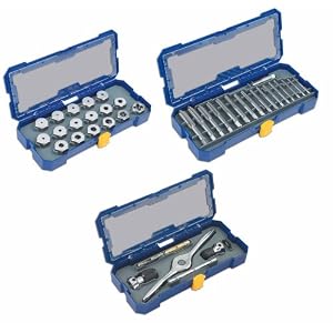

Weekend project was the change the struts on the car...and one of the bolts that mates the strut bracket to the lower control arm decided to snap! Don't know why they felt an little 12mm hex head bolt (M6-1.0) was a good idea for such a vital component. :dunno:
Anyways, I was able to grind down and drill out the snapped bolt. Now my problem is I dont know what type of tap to use. I had a cheapie HF tap set on hand which did absolutely nothing. All the cutting threads just got mushed.
What would be a good set?
I currently have my eye on the Irwin/Hanson 'alignment' set:
http://www.amazon.com/dp/B002M78R68/?tag=atomicindus08-20
But it seems like most of you guys use the set that SO rebadges:
http://www.amazon.com/dp/B0000DD4KV/?tag=atomicindus08-20
Does the second one have any advantage over the first set? I like that the first set 'aligns' and has ratcheting adapters in the kit. And will either of them have a problem cutting into the control arm metal? I assume it is super hard metal...

As a rule of thumb, but NOT always true..... The less you pay....the less the quality.
Most of my taps and dies I got from my father, a post WWII machinest. They are top quality and I treat them with care and respect.
HF has made a brand based on cheap. I wouldn't use their taps, you break off a tap in a hole your little problem just multiplied to a HUGE problem!
You also need to know what you are running a tap into, a hardened steel will be a lot harder to tap than mild steel.
Take a sharp file and file a spot on the metal, does it file easily or does it laugh at your file as it glides over the steel doing little if anything? Hard steel with be difficult to file.
Go and get the best quality taps that you can afford and proceed cautiously. Taps are easy to break, when running in a tap, get it started, turn it in a turn or Two, back it off a turn to break off the metal curl that you are creating, turn it in another turn or two, back off, turn in, back off until you are done.
Use a cutting oil, or at least an oil to cool and lubricate as you cut.

What would be a good set to have as an only set? I certainly do not have enough money to get multiple style sets... Are the Irwins tapered? And if so, would that be good enough for DIY use?
The hole I am retapping does not go all the way through. Is that a 'blind hole'?

Yes, that is what you call a blind hole. You need to use a bottoming tap.

Yes that is a blind hole. Ultimately you will need a bottoming tap to finish cutting the threads. You can grind a taper tap into an intermediate and bottoming tap but obviously you can't go backwards from there. Good Luck.

The "normal" type of tap found at the local hardware, auto, and discount
store will be of the tapered variety. Intermediate and bottoming taps are
usually found in industrial supply outfits. Yes, a hole that doesn't go all
the way thru is a "blind" hole and requires a bottoming tap to properly
thread the hole. My trick: take a spare tapered tap of the correct size and
grind the taper off of it leaving the rest of the tap intact. Start the threading
process with a tapered tap, and finish it off with the homemade bottoming
tap. (I can hear the groans now from some of the gang out there, but
if you are careful, it works, and I don't have the $$ to spend on fancy stuff
that I only need very ocassionally. )

Taper, plug and bottoming are how I know them.
I've often taken a taper tap to the belt sander to make it a "bottoming" tap. Not technically correct, but it works.
Both Enco and MSC are currently selling Cleveland hand taps in sets of 3 - same size of taper, plug and bottoming. I'm gonna order a 1/2-13 and cost is around $38 in that size. They're not showing the metrics on sale tho of course.
You've also got hand taps (generally good for just that), spiral point (pushes the chip ahead for thru holes), and spiral flute (kinda like a drill bit and really a lot of fun to use as it strings the chips back out of the hole). Spiral flutes are great for spanning keyways too. Plus many others.
Irwins are fine. I usually order Kennametal, OSG, Cleveland or Hertel (most Hertel stuff made in US).

I call them tapered, plug and bottoming. Most sets will be plug style, (intermediate) and almost all tap and die sets are high carbon steel, otherwise a set would cost hundreds of dollars.
I find a complete or semi-complete SAE set (national course and national fine) is good as an occasion comes up for a tapping job, or just use the taps and dies as thread gauges.
The high carbon steel is good for a few go-arounds, then garbage. At that point throw them out.
The HSS (high speed steel) is preferred, and is often on sale at ENCO or MSC, Travers, etc. You can get a 'set' ( taper, plug and bottoming) or buy the specific tap you want.
Even HSS will wear eventually. When the cutting tool stops working as it should, throw it out and replace. Disposable tooling, you know.
