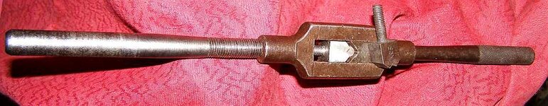

Originally posted by myself
Another job I've had to do to give me more workshop equipment has been to repair an old tap wrench.
This was something which came upon me because I just couldn't resist it. I don't recall now where I got the wrench, but one handle was missing, the one which screws in and out to enable fitment and to hold the taps in place. It was a P & N brand, which used to be a good brand in Australia.
The first thing I did was work out that the reason the handle was missing was because the thread inside the body into which the handle screwed was pretty much all gone, I had access to a similar one at the Men's Shed and saw that the thread was ⅜" UNF, so I ran a 7/16" UNF tap down it and dug up some material from which I could machine a new handle. That was part of an old rusty Valiant steering column and over a couple of sessions at the Men's Shed I got a result:
New handles. There are two handles here because I didn't have a left-hand tap to run up inside the handle so the sliding section of the wrench would function as designed.
The thread on the sliding piece is ¼" in diameter, so one of the new handles was drilled to that size, the other was drilled to 3/16" in the hope that one day I'd get a left hand tap and cut the thread. Which we assumed was a UNC thread.
Much later (the handles were turned up in 2021) I obtained a left-hand tap and die nut and over a period I machined up another piece of Valiant steering column to begin the job of making a new sliding piece. The reason for this was that it wasn't a UNC thread at all, being a couple of threads per inch different. Which I had established when the tap and die set arrived from China.
Left hand thread. Though the thread is already cut here, I set this up to show how I got the die started straight. The threaded section and the sliding insert are made in one piece.
After forming it up thus far I went back to Angle Grinder Engineering and set about turning the round section into a square - or nearly a square - so it would fit into the wrench.
Forming the right shape. I reasoned that I could get the sides to be 90° to each other if I was careful using this method. It worked.
Eventually, by careful use of the angle grinder and trimming with files I got the job done...
The finished tool. I was pretty happy to see this done after such a long gestation period. A little adjustment was still to be done, but I'd achieved what I'd set out to do.
And a little closer:
Closer look. The adjustment mentioned was to allow the handle to screw in further, which this shows it needs. Also shown clearly is the original sliding piece with its odd thread.
