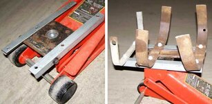

Back on track, this week I'm changing the rear suspension of the Territory...
It's a terrible setup, having eight 'Rose joints' (ball joints which bolt in like regular bushes) and a further eight regular bushes attaching things to the cradle - though two attach to the chassis) wherein the differential is also mounted on three more bushes. And this isn't counting the shock absorbers.
I bought all the mechanicals out of a similar model in a scrapyard and decided the best way to attack the problem of severely worn bushes and 'Rose joints' was to put the whole rear end out of the other car in to give me a chance to deal with the rest in my own good time. The replacement cradle and all its fittings didn't look to be in such bad order.
Apart from the basic problem of having to get under there and start undoing things, I had the issue of how to lower the cradle when it was undone, how to move it out of the way and, in particular, how to safely put up the replacement. In a way it was a similar problem to that I faced some time ago changing the gearbox in the Dodge.
At that time I made up a framework to fit on my large trolley jack, based on a piece of scrap which I machined (again at the Men's Shed) to bolt on where the little swivel belongs on the jack. To that there were two pieces of angle added, these being able to pivot, and then I bolted up the frames which would support the gearbox:
Set up for gearbox changes. Simple enough once I made the central piece which bolts onto the jack where the original swivel lived.
So I went back to basics on that and last Monday took the top sections off and made up cross pieces which would fit in with the Territory's suspension cradle:
Change of purpose. More scrap metal used up, this is the frame for getting under the Territory's cradle...
Perfect fit. ...and this is how it fitted up under the cradle.
So I was able to lower the suspension complete and remove it from under the vehicle...
Success! This made a difficult job quite easy, but it took me a few hours to make up the bits.

My back *****, so I am always down to use any tools I can to minimize straining it. For instance, I use my cherry picker to lift/lower the big cast-iron cylinder heads on inline engines. Sure, I can lift them, but as I get older, it's not wise to dead-lift a hunk of cast iron with my back bent and my arms outstretched. Plus, lowering it nice and controlled with a picker makes sure the gasket surfaces don't get nicked from slamming it down, or scuffing it.
An old mechanic once told me "if you're grunting, you're not using the correct tool". Now, you may not own the correct tool, but it's out there, lol.

I've never seen anything like that, to be honest...
But I just had a look for similar things available here. For a 227kg one, roughly similar to the one Harbour Freight has for $250, we'd have to pay $AU510 (about $US380), a 350kg one, still not as highly weight-rated as the one you've linked, is $AU1,060 (about $US710).
They certainly look handy, but perhaps not as flexible as my little hand operated forklift. With it I can pick up items to put them on a pallet (I will get around to making pallets that stay straight, by the way, and have a good surface), then back out, pick up the pallet complete and it will go up to a ton. I don't know what that cost the bloke from whom I traded it (swapped a dismantled single car carport plus a little cash), but I know I got very good value.
Here's one available in your land for about $US270:
But I do feel that items like this are a part of what I had in mind starting this thread. Though I do prefer to see innovation, improvisation and putting old junk to a useful purpose to spending too much hard-earned.
