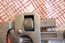

And a recent find (antique shop, Minocqua, Wisc.) — a 6-inch Walworth Stillson. I've sanded, stained, and shellacked the wood handle and cleaned up the metal.
It's a cutie and a keeper.
Edited to ask — What does the stamping on the non-Stillson side of the moveable jaw mean? (Looks like an old fashioned dip-pen nib, but that can't be the case.)

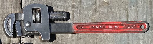

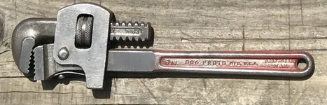

Not sure if anyones still paying attention to this thread, but it’s all new to me because I just found it. So here’s my contribution, my smallest pipe wrenches 6-10”. 9926453D-2F5C-46D2-A3A0-DC69B3EEA3ED.jpeg0CB9B191-A918-4432-8BD6-D8C647AA3EFB.jpeg
I’ve made it somewhat of a hobby to restore old tools, mostly pipe wrenches. Some back close to their original state, some not so much…….
