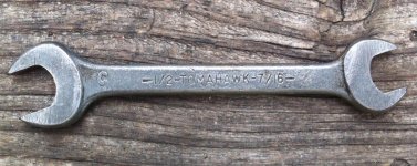

Here is the first Tomahawk DOE that I've run across. Username has several and they seem to have been made by Barcalo but the brand was sold by Walden Worcester. Here are pictures of my recent find followed by Username's comparison shots.
