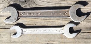

Nice work.
I think unbranded, early Bridgeport. Before the Pyramid and Hy-bar designs.
I'm with you on the Bridgeport, but I was thinking later, after they switched from Molybdenum Alloy to Forged Steel and eventually just Forged U.S.A. markings. I could be wrong.

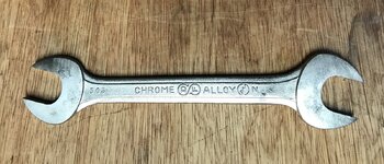

Here is a DOE I found at a Tahoe garage sale yesterday. This mystery logo has been discussed before. As I was reminded, Lugz posted a perfect handle screwdriver with the same logo. It came out of the evaporust this morning and since it was chrome plated it received the full treatment. Maybe there are enough clues to figure out who made it. 313974F9-D29A-418F-9E71-46655357824C.jpeg92666637-6027-43D6-B73B-547075E9A89B.jpeg
After cleanup 0326B7BA-ADA0-4FD1-B2C2-AD7D960F914F.jpeg5F190570-1C75-4B70-982F-2D1B5BE93DD9.jpegD55A8398-A2AC-419C-8A43-C8886B154A5E.jpeg6DD36D86-1A2B-45D0-BDF4-F8D76ABB711E.jpeg8576E06C-345F-4B2B-B8F6-AE58A905D695.jpeg
LesserSon
Feb 7, 2016
5,047
PA USA
Now it’s out of the bath, the second circular logo is clearly the Japanese Institute of Standards!
30,468
It seems almost inconceivable, Don, but I don't think that "S" and "DF" monograph is the same as the "S" and "DF" monograph on my old perfect handle screwdriver. My "S" has standard serifs. That "S" has curlicues or whatever we want to call them. And the Japanese governance marking makes it seem even less credible.
My speculation on mine is H.D. Smith which used a large "S" early and made drop forgings (for carriage parts, etc) early. When they started making tools, they continued the "S".

Even Mrs Farmer J looked at this mystery over her breakfast, and says "Maybe it was made somewhere not in America and taken to California by someone who went there"..
I will have a look around see if I can find any similar logo.
Meantime, does the 662-B and the dimensions of the jaws give any indication?
30,468
The 66X scheme is the ISN for a short "S" wrench. The suffix indicates different sizes. 662's went from A to at least H. This model numbering scheme comes from Williams, but by the 20's and 30's, everyone was using it, even Billings. I have a few Williams examples posted on this thread and the Williams thread. If you search on "662" they will show up. They are all marked (forged "662" plus suffix stamp, all forged, or all stamped) closer to the major jaw head.
I am inclined to think that's an MDF wrench. What makes more sense? Some previously unknown OEM with an "M" in an oval instead of a circle? Williams with a circle instead of a triangle? Or MDF in a squashed die?
leg17
Aug 11, 2011
1,366
Kentucky
That M/W in an oval logo has come up before and has, so far, garnered a gaggle of guesses.
It does not seem to be Moore, Manzel, or Williams.
30,468
That M/W in an oval logo has come up before...
It has, including your thread, for further examples and reference, here...
EDIT: I see that you referenced my name in your first post in that thread, with a post # (484), and a link to the JH WIlliams thread, but post #484 in that thread is not mine. Did I say something about this logo in the JH Williams thread before? If so, I can't find it.
28,505
:thumbup: Occam's Razor.
I've spent the last week or so scouring ebay looking for different variants of "CHROM VANADIUM", which had me visiting ebay.de, ebay,it, ebay.uk, among others ... (I can almost spell Shraubenschlussel now without having to look it up) ... I have not seen anything like "M in an oval", and the more I think about it, the more "MDF squashed die" makes sense.
