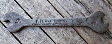

Ran across this little gem at an estate sale, one end is marked 7/16 (actual opening .775") and 3/8 (actual opening .700"). What is it?

Mintgrun

I'm thinking this might be a rare little wrench, since AA said F. H. AYER MFG. CO. of CHICAGO HEIGHTS, ILL, USA only made pressed steel socket sets. I did a little searching in the digital world and didn't find another. Without further ado,

O
39,382
Yes, they "sized" the wrench to the bolt thread, but the bolt head obviously had to be bigger. Completely Bas-ackwards to the conventions we use today.
13,294
Yes but 3/8 is .375" (not .700") and 7/16 is .437" (not .775") Am I missing something?
Several early thread standards, the link below was one. The early bolts were sized like Whitworth, where the wrench was labeled for the threaded shaft size, not the size of the head.
Several threads cover this on the vintage side.

The opening correlate to U.S.S. sizes, if you allow the openings to be slightly (.010 to .015) oversize to allow easy fit. 11/16" for the 3/8" fastener head, and 25/32" for the 7/16" one.
