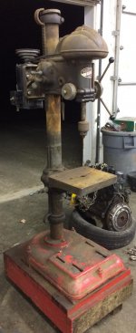

Sitting here bored at work I finally decided to start posting on the forums. I picked this up at a garage sale for $30 a while ago.
The first picture is me taking it home. That thing was a beast to load into my truck.
Knew it was a great drill press because I had always lurked this site and followed this thread.
Now I'm happy to say I can post in it.
Original plan was to clean it up but then I just started using it and gave my dad my old (new 2017) bench top craftsman drill press. So now I can't refurb it.

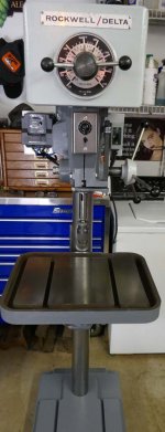

I just completed the restoration/rebuild of this Delta/Rockwell 17-600. I decided to VFD it. I used a Baldor 1.5 HP 3 phase TEFC motor and a Teco L510 VFD.
The Reeves speed dial adjusts it from 350 - 4250 RPM and the VFD can get it down to 25 RPM at the 350 RPM setting with enough torque that you can't stop it with your hand. It also gives you reverse for L.H. drilling and makes all speed tweaks fast and easy. I could overclock the motor to get >4250 RPM but that already seems plenty fast.
I'm less then thrilled with the Reeves VS system. (never had this style machine before). I guess it's common for them to be noisy from belt squirm. I think I prefer my older 17-600 which is much quieter.
DP restoration can be kind of addictive.
I heard from someone that the Powermatic variable speed drill manual recommend paraffin wax to be applied to the belt to quiet down. I tried it and it definitely reduced the belt squeal.

Serial number is 26-86110

Nice job on the Delta 17. I'd suggest that you find some cast belt covers and the period correct Delta motor for it. They are fantastic machines.

Wow Jason, great score. Don't often see a head raiser and table raiser on the same machine. Is the motor missing the cap, or is it a 3 phase motor? If 3 phase, consider adding a VFD. PM me your address and I'll send you the missing nuts and special washer for the depth stop.
