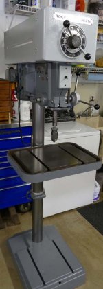

Thanks to member 454ragtop for providing me the oddball jam nut, I was able to complete this DP project.
It's a mid 1970's Delta Rockwell variable speed #17-600 w/1 HP motor and large production table in almost perfect shape. It just needed some bearing service, cleaning, fresh paint and assembly.
I might VFD it later.

Awesome job, looks fantastic. :thumbup:

Very nice. Am envious.

Reverse!! I put a VFD on mine to run in reverse. broken bolt extractions with a left handed drill bit is the primary reason. and because I wanted to try my hand converting a DP with a VFD.

WHY? What would you gain by putting a VFD on it when it's already variable speed?
It's currently variable from 350 to 4250 RPM. I could add a VFD and overclock the motor by approx. 30% and get to over 5000 RPM. Or turn the speed wheel down to 350 and then dial down the VFD to around 10 Hz. That would get me <100 RPM.
It's also quicker and easier to turn a little potentiometer then to turn the speed wheel.
And you can also get reverse with a VFD.
It might not be worth the expense/hassle though.

Dave the drill press looks awesome, nice job. The one I parted out (it was missing a bunch of parts) had a Rockwell 2 button switch to control a mag starter on the front of the head. Don't have it any more though, sold it thru OWWM a while back.
