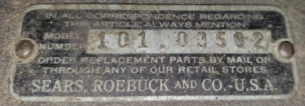

So here's something interesting I learned about this drill press. I decided to poke around on it last night and somehow had never cleaned off all this compressed grime on the base. Lots of metal shavings and sawdust and whatever else had made a little cocoon and covered up this bit of information that I never saw before:
