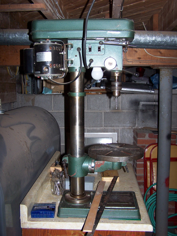

Just picked up this Walker Turner serial 1-944 appears to be complete with foot control.
It’s oversized for what I had originally been looking for a bench top as my garage is not the biggest. Needs a new outlet plug as the original 2 prong is cracked and the toggle switch may need to be replaced but I do have the original switch housing.
What’s the best way to clean these and restore? Not sure if I’ll repaint it but at least get everything cleaned up as it has a fair bit of saw dust on it.

So I took the entire press apart, cleaned everything. Stripped the old paint as it was chipped etc. Going to repaint in and in the process of currently doing so.
After inspecting the parts and pieces, I noticed the belt that came with the unit is in rough shape. On the belt its written Gates Truflex 2450, when I look at the Manual from VintageMachinery it lists the Belt as a VB42 - 42". However when I search for this belt under that part it lists it as 44".
Any idea what I should be getting? The Gates one that I took of measures approx 21/22" half size so its like 42/44" lol.. What is the correct belt as the manual lists 42" but the part it lists comes back as 44".

The VB42 was probably based on 42" inside circumference. On a 1/2" belt that's the same as 44" outside circumference.
I bet the Gates 2450 is 45".
Get either VB42 or 2450 and you should be fine.
V Belt specs can be confusing.

Thanks! And you are correct, further research show that exactly. I’ll get a belt that’s 44” which is what the manual calls for.
I will be assembling this again in the next day or two and I’m curious, for the quill I was going to use grease for where the teeth mesh etc. However for the other parts that hold the table, quill etc. I was going to rub it down with just motor oil as I did use a fine brush and remove all the surface rust. Also intend to apply a thin coat of oil on the main column that holds the press. Is this the stuff to use or what? I don’t think there is any need to use grease on all the components?

I have had good luck lately with Boeshield. Won't attract dust as easily if at all.And has a wax like finish when dry. check it out.
Davefr
Jan 7, 2010
11,868
OR
On my DP's, I use Superlube silicone grease on the quill and table lift gearbox. I use it very sparingly.
For metal parts like post, table, etc. I use Johnson's Paste Wax. Sometimes on cast iron tables I use a thinned down polyurethane and wipe it on then wipe it off. (just enough to dampen the surface but not enough to build a layer)

So gentlemen, I’m putting this thing back together and all is going well except the return spring doesn’t seem to be effectively working. See the video below I took.
Basically the tighter I wind this thing the less the quill returns and the harder it is to even lower the quill as I’m winding it more then.
If I do it a few times then I get the response as the video below and it goes back a bit then stops. I can’t seem to find the sweet spot. The bolt and washer on the outside of the return knob are not very tight either in order to let the handle spin back.
Can someone enlighten me what’s going on? I degreased the return spring but never took it out of the housing. Should I spray it down with something or grease again? Between the quill and pinion I applied No. 2 grease (red), but I wouldn’t believe this would cause the sticking?
Does the quill need to be in the fully pulled up position or lowered position when I install this thing? I just of this and not sure if it makes a difference? I’ve been doing it with quill fully lifted up (chuck at the highest position).

Make sure; quill is oiled and spindle oiled where it goes in the pulley. Quill lock not too tight. And pinion seated properly, ( not too far out and not to tight either)

Well the quill isn’t oiled it’s greased.. perhaps that’s is my issue? What is the spindle your referring to and to what pulley?

Is the quill lock lever totally free or creating some resistance? Is there a small quill adjustment screw that's too tight?
Is the depth gauge rubbing against it's guide?
Does the quill raise up and down smoothly without the spring?
Are you sure the spring's housing is not causing binding anywhere?
Are the casting holes for the handle shaft clean and lightly lubricated?
Does the spring look like it's original and not broken or modified?
Just some suggestions.

Quill lock fully disengages, I’ve even pulled it out to see and no difference.
I removed the depth gauge afterwards as I had thought the same thing was perhaps happening but this isn’t the case.
Yes goes up and down very smooth. It’s so smooth that if I remove the quill lock and pull the return spring the quill pulls itself down without any effort. So it slides smoothly.
I don’t think it’s binding but once it’s on there it’s hard to see what’s going on.
Everything is lubed and I checked again.
It looks original. It is broken now the piece snapped off.. gonna have to drill a new hole in it to catch on the set screw... last piece left to have this thing put back together.
