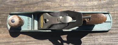

I just got plane lucky this weekend. Picked up these two at different places. The bench plane is a Standard Rule #4 size, Standard Rule made planes using Solon Rusts 1883 patent until bought by Stanley about 1891. The compass plane is a Stanley 113, very late, probably WWII vintage.
Does the Standard Rule have the lateral adjuster? Not many had that.

I don’t have any idea. I only picked them up due to the Wards connection, plus they were extremely inexpensive. Planes really aren’t my thing although I have several.
I think those were both made by Stanley, the Power Kraft is probably a Stanley Handyman H1204 with a "Power Kraft lever cap (pretty easy pattern change" and the Wards Master looks like a Stanley Bailey #3 with a twisted lateral in place of the insert type used on their own branded planes. Stanley even used a twisted lateral on the Bedrock planes they made for Keen Kutter and Winchester.
