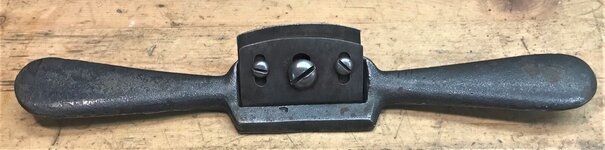

Your other one appears to be a Ba(t)chelder, the T seems to be optional in the spelling. Inventor and Mfg, under the name A.G. Batchelder from 1820- 1878, and A.G. Bachelder from 1847-1868, and dragged a son in from 1867-1873. He was influential enough to warrant about 12 pages in the book.
With some details, I may be able to pin down exactly which one, size, overall view, etc
CRSINMICH
Aug 15, 2015
2,433
Southeastern Michigan
RTM: It's the one on top of the photo. The only difference I can see is there is no hang hole in mine. Thanks for the information. Now I have to reassess my plans for it.

According to the book, the very earliest B spokeshaves are believe to have been marketed completely unmarked, or only on the cutter. The top edges of the early ones had angled cutters. Bodies were very similar to those made by E.F. Dixie of Worcester z(hmm, another player in the game). Approx 1/2" longer at 9-1/4" per picture captino above. There are some variation in the front of the mouth, none shown on yours. Your handle design is designated C, very plain.
That's really all of interest that they have on the three screw shaves.
CRSINMICH
Aug 15, 2015
2,433
So it's early but plain. I ran across a couple comments saying that they are not rare. I'll have to decide if I want to renew it or leave it alone. Thanks again.
13,329
I know I've seen at least one before, so not horribly rare. Nice to hear others have the same opinion. Go wild, make a rock star out of it. Pinstripes might be a little much.

Back in September RTM identified this spokeshave as a Batchelder adjustable cap iron shave ca. 1875-1880. I decided to give it a full restoration. I tried my hand at japanning and it was fairly easy to do but, as with many other things, surface prep is critical. While I was at it I gave the full treatment to a 4" Starrett No.11 combination square.

tx: The product I used is called A Plane Life. It's 40% BLO, 40% turpentine, and 20% asphaltum. Preparation is to completely strip the metal, wipe it down with turpentine, and then wiping it with acetone just before applying the japanning - no fingerprints. Apply a thin coat with a fine bristle artist's brush. Let the piece set for 20-30 minutes then heat it to 180-190 degrees for 2 hours. Allow the piece to cool thoroughly before slowly raising the temperature for a second heating to 350 degrees for another 2 hours. If you've done it correctly, the piece will be an awful blotchy brown. If it's black then too much japanning was applied and it might not have cured correctly. Repeat the coating and heating process until the piece is as black as desired. The spokeshave needed three coats but the square only required two.
IMPORTANT: The instructions say to check the temperature of your oven with a separate thermometer. The toaster oven I used was heating at a much lower temperature than the setting. I had to heat the second coat twice after I discovered that.
