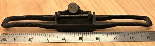

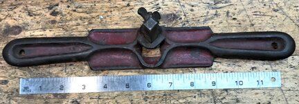

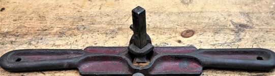

Does anyone recognize this router plane?
I thought it was a spokeshave when I first saw it. There are no marks anywhere. The sole has a slight radius. It doesn't look shop made.
13,531
I'd guess coachmakers or patternmakers router plane. Searching through ITCL did not get anything under the patternmaker search, ran out of boring meeting to search the coachmakers.

CRSINMICH
Aug 15, 2015
2,480
Southeastern Michigan
paulsomlo: I found this in a 1901 catalogue from Montreal while I was looking for information about the spokeshave above. You can make a side by side comparison and it's worth noting that the #20 was priced 50% higher than the #113.
