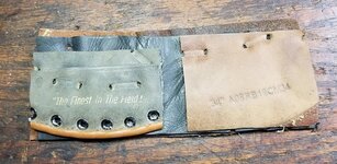

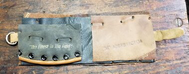

Taking opinions on a cinch. I keep waffling back and forth. On one hand I really like it as an extra flourish, on the other hand I worry about it being overkill/an affectation too far, or, worse, them thinking it looks feminine, despite the context of the baseball glove, or an inconvenience, and disliking it.
