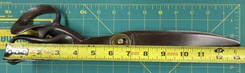

The 14” heavy tailor R Heinisch at the bottom of frame were a recent gift (as was the cutting pad). She said her father used them to cut tin. The brass pivot was semi-mangled around the circumference with pliers toothmarks. I guess a PO tried (and failed) to take them apart that way.
Marred to the point I could only make out “Newark NJ,” so I tried to flatten the edge with hammer taps, and wound up filing the remaining ridges down to reveal the lettering. I found a c1915 catalog on ITCL which shows “USA” following “NJ,” so I guess earlier than that, maybe c1900?
LesserSon
Feb 7, 2016
5,106
PA USA
I didn’t find a clear size on them - just an “H” stamped into the steel.
They are slightly over 14”OAL, and slightly over 7” along the edge, but only by 1/8” or less.
My analog postal scale only goes up to 2lbs, bottoms out with these on it. My antique 25lb scale says they are 2-1/2lbs, and my bathroom scale (with applied subtraction) says 2.2lbs (but I probably wasn’t standing still).
IMG_8511.jpegThat all matches the catalog-given weight of 2-3/4lb well enough. For sure, they are not 3lbs.
In the group photo, the ends loom above the cutting mat (closer to the camera lens), so they appear larger. I can make them appear shorter than 14” by placing the measuring device above, rather than below.

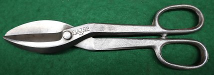

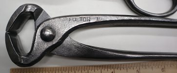

Need help identifying these. They are all Fulton. The top one is stamped Fulton, Made in USA and has nut/bolt type pivot. Has a handle stop similar to Wiss. The middle pair is marked with Forged Steel cast into both handles and is stamped Fulton AE Made in USA. Has a round head on one side and a nut on the other for the pivot. The pinchers are stamped Fulton AM and the pivot is a swaged over rivet.
Note: Neither the AE or AM are listed on Alloy Artifacts under Sears manufacturers codes.
Also posted this under the Fulton thread. https://www.garagejournal.com/forum...ls-sears-private-label-brand-11-14-25.552392/
Adding to this post. I just received a 10" pair of snips marked Fulton B-G. So to recap, in the last two pictures are the three that I have. From T-B: Fulton Made in USA, Fulton AE Made in U.S.A. Forged Steel, Fulton Made in U.S.A. B-G
