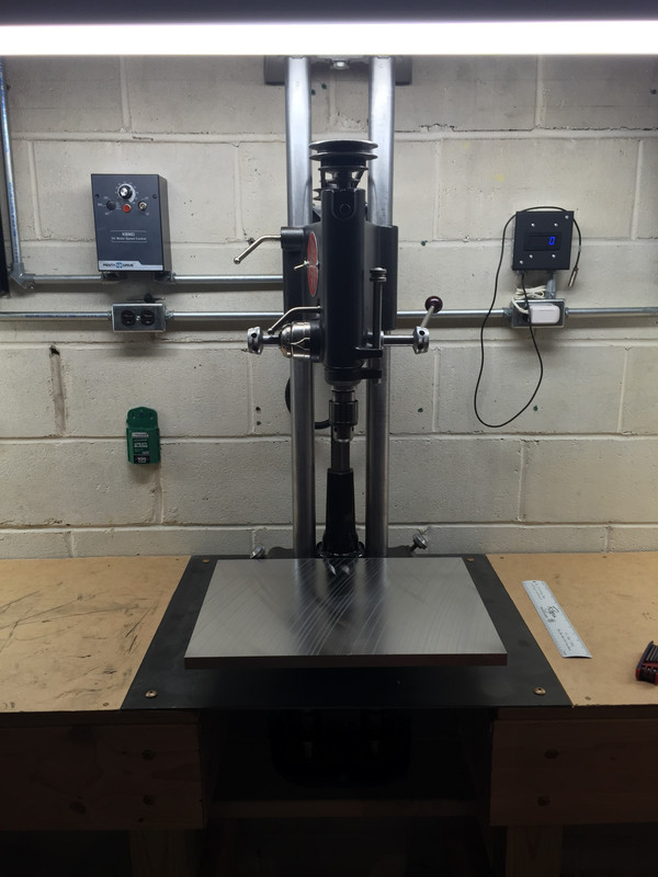

So little update... I decided to pull the trigger on the VFD...
then very last minute I found a thread or
YouTube video while my baby was keeping me up all night and it talked about the chances when using a VFD for a disc sander that the dust could burn it out in a short/shorter period of time. That you should make an enclosure for the VFD and add filters. Then some folks said the filters can over heat them... Then I saw some folks saying they have no filters and have been running their setup with no issues.
I figured I would pay a little more just to ensure I would have no issues down the line.
So I decided to go with the kbac-27 which is rated up to 2hp. The disc grind has a 2hp baldor motor. I got it hooked up and when I turned it to full speed I would get a fault error code (overloaded/underloaded) I called the tech support and they said even though it 2hp motor it’s drawing more amps. So I returned it and got the kbac-29 (it’s rated up to 3hp) and I finally got it up and running... still need to dial in all the trimpots to ensure its functioning correctly.

Did you have any luck with adjusting the Current Limit trim pot on the KBAC-27D? Based on the manual I think that trim pot should help limit motor power, it needs to be tuned manually.
Currently on the fence on the KBAC-27D and a KBDA-27D.
