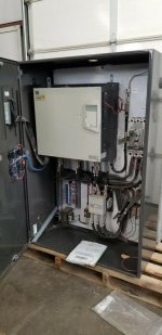

Thought you all might appreciate this pic. These are trolley bus brake resistors. When they're regenerative braking, they'll put current back in their battery pack. If that's full, then they'll push back to the grid. If they can't do that for some reason, then they'll push to the brake resistor. The really old buses would use it as part of the HVAC system.
