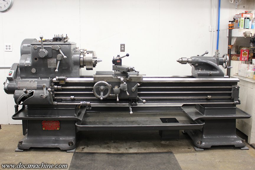

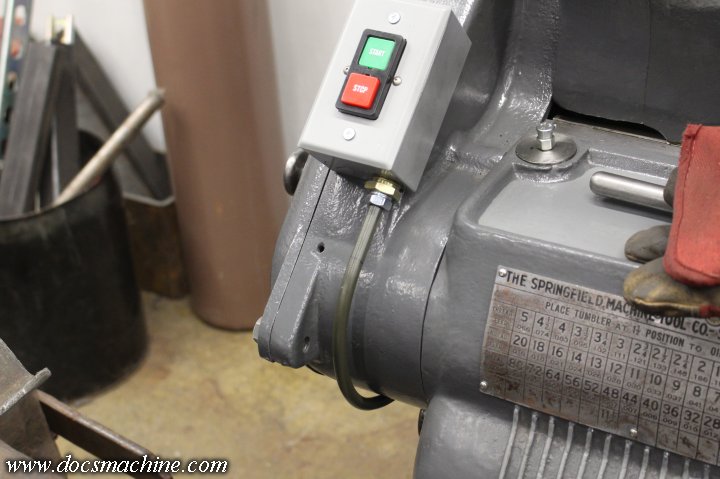

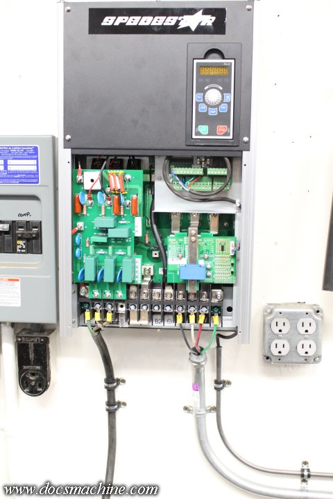

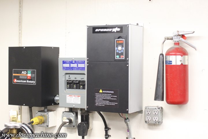

How about a 10HP Polyspede 'Speedstar' VFD...
Wired to a remote set of buttons using 3/8" steel fuel line as conduit...
All powering this monster:
I'm given to understand that's the biggest single-phase-in/three-phase-out VFD available. I could have cheaped out on a Chinese "10HP" VFD off eBay, but with the time, money and labor I have into this thing, it was worth splurging on the good stuff.
Doc.
Doc.
Doc, it is a “thing of beauty” as they say..... nicely done on the conduit work.

It seems alot of VFD manufactures have made the conduit connection panel an optional feature. I would agree if the VFD is mounted inside cabinet all the time but, the larger ones may not be for cooling issues and shear size. You can purchase the panel if you wish to terminate a conduit to the VFD itself
u3b3rg33k
Dec 18, 2017
4,084
It's usually "standard" on anything with a proper housing/IP66 rating. costs more than buying just the drive itself of course.
once you get over a certain size it seems to be harder to find too, but that's a different problem.
