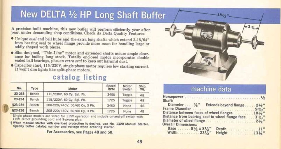

I don't know what it is, but rusty tools have a habit of following me home. Once there, they form up into a growing que where they quietly await my attention. I'm certain many of you can identify. This weekend, I finally brought home a tool to IMMEDIATELY help expedite the line.
I watched this one for more than a month. Advertised as a grinder, it started out at $200. When it hit $100, I inquired if they had the guards or tool rests. "No". Simultaneously and without saying a word, they dropped the price to $80. Finally after slowly trading emails for the better part of a week, I was informed the cord had been damaged and would need to be replaced. Of course that also meant there would be no way to test it. I offered $60. "Sold". When I went to pick it up, it was obvious how the cord was damaged; they had sold the base to someone else. "Yeah, a couple days ago, someone offered us $100 for the base alone. Can you believe it?" I didn't so much have a problem with them selling the base, though I would have liked to have it. What bothered me was they hadn't said anything. Mad, I offered $30. They accepted and, still focused on the missing cord, offered to refund my money if it gave me any problems.
From the ad:
Turned out it never was a grinder.
I've kicked myself for the last 2 years after passing up a similar Baldor for $25. That was before I realized I would have a use for one. Of course you always hear about Baldor buffers and grinders. Is anyone familiar with this Rockwell (Delta) model? Any issues? This is their long shaft buffer which appears to have been introduced in 1960 or 61. I threw on a temporary cord, careful to match the original wiring. The leads from the winding itself seemed fine. This leads me to my first serious quesion:
How much heat buildup is normal? This motor is fully sealed so I expect the case is going to get warm but it warmed noticeably in less than 10 minutes. Anyone else have experience with that?
My other question is, how freely should the arbor spin? It turns easily enough but if I spin it by hand it only goes a revolution or so before it stops. I am aware there are seals on the arbor. Those could be causing the drag, or I might need new bearings, or? And where is all the oil build-up coming from? It was worse, I've been cleaning. It is mostly on the top side so I'm not too worried.
As a side note, I'm glad the PO and I didn't fool with the cord. It certainly would have shorted. Consider this a friendly reminder to inspect your old corded tools, be they portable or stationary. This insulation was only 45 years old (born Summer 1969) and even within the base it had the stability of a saltine cracker.
So here she is at home:
Her papers (23-233):
I have read several places that you need to use a guard with a wire wheel. Is that equally true of all wire wheels or is it more an issue with newer / cheaper wheels / imports? This machine was originally sold without one.
Thanks
The motor plate should tell you what the temperature rise is supposed to be.
It will say something like "Rise 40C Cont." or "Rise 50C Cont." That means the temperature can increase as much as 40 or 50 degrees Centigrade above ambient temperature.
The bearings, rather than the seals, may be causing heat build up if they're approaching end of life and most of the grease has dried up or leaked out, allowing more friction.
Frankly, I think it's safer to use a wire wheel without a guard. With a guard, small parts can end up getting caught in the guard if the wheel catches them and pulls them out of your hand. Then they fly around the inside of the guard and get thrown out at you anyway.
Wear safety glasses, or better yet, a face shield, when using a wire wheel.
7th Kahuna
Aug 4, 2012
1,704
Los Angeles, CA
Ah, thanks for the explanation. They don't exactly make it clear.
Max Ambient 40° C - So the operational temp is ambient plus 40°? It was 90° today so this buffer could potentially maintain a surface temp of 130°?
I guess it may be time to pull apart my first motor . . .
Half the safety devices out there seem to make one element of the operation safer while making three others less so. I was considering making some basic guards but I suspect you are right. I would rather have the lost piece thrown to the floor than whipped around inside the guard and thrown back at me.
Thanks for your input.
WWIIjeep
May 30, 2012
1,240
Arizona
Celsius/Centigrade, not Fahrenheit. 90F is about 32C (because I doubt you meant it was 90C in LA today), ;) so 32C + 40C = 72C, or 162F inside the motor, so yeah, the outside could easily get to 130F or a little more.
The markings on your motor are the modern way of marking the temperature rating. What I described in my earlier post was the old way, which is how I assumed your motor was marked. The older way is easier to understand than the new way, which requires that you know the temperature limits for the various classes of insulation on the motor windings.
With class A windings and 40C ambient temperature, at sustained full load your motor could potentially get considerably hotter than 72C. The likelihood of it ever actually getting that hot on the outside of the case is slim.
Practically speaking, on a 90F day, you can probably touch the motor housing with your hand, but you wouldn't want to leave your hand on it.
Funny, I knew they had different zero points but apparently I forgot about them having different unit sizes. Either that or I slept through class that day. :D
All worked out in the end though. Thanks for the help. I'd say the warm up was within range, but I'll still plan on opening it up to check the inside.
