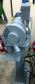

Here's a Cincinnati from the 1930s that I just finished up. It came out of a carpentry shop, and used open bearings -- the grease and wood dust really clogged things up inside. There were about 33 coats of paint on it too.
Everything was blasted to white metal with garnet media (even the stator case -- had to press the windings out... not easy), then painted with a polyester epoxy marine paint, applied with a roller. Cast iron really ***** that stuff up, and small voids can be filled without using any body filler.
As I don't have three-phase power, a VFD was required. Found a small one in the parts bin and installed it in the pedestal, and ran a power cord out the back.
Photos show it nearly complete, I still need to paint the switch box, touch up the fastener heads, and install the tool rests.

Nice grinder Kevski!! Great job cleaning it up too!!

Kevski: just curious how you ended up keeping your VFD in place inside the cast iron stand? is the conduit from above holding it up inside? awesome restoration and i do like Cincinnati grinders.
