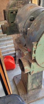

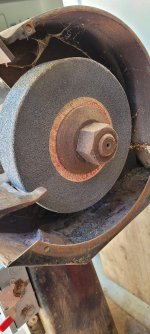

I have a Van Dorn 8" grinder 1/2 hp, 3600 rpms, 110 volts, 8 amps, Serial No. 110724. It runs fairly smooth. Manual grease opening on the top sides of the motor. I believe its pre 1925 model. Can't find any pictures on the web to show what parts are missing. Would this been worth a $100?

I would have paid that. Some wouldn't. After cleaning it up some, I think you will be pleased. They don't make classics like that anymore. Good pick.
39,566
Like Mike said some would some wouldn't
Too many questions for me:
Key is how are the bearings? with those oilers it may be Babbitt sleeves. Is the armature rattling in those?
No guards, one pitiful rest. those are essential at 3600 RPM adn ay 8"
I'm a bit surprised at 1/2HP for an 8" wheel. but it's also 8 amps at 110V, We are at 122 most places these days... so it may be closer to 1HP in reality? Surely at least 3/4
My "Load test' for a grinder is to laod the wheel with a 2X4 and see if I can stall it, and how easily.
It's like an old brass fan. Do a quality restoration and put it on display. It's really cool. However I wouldn't use it. (8 amps, 8", wire wheel, no guards - what could possibly go wrong!!)

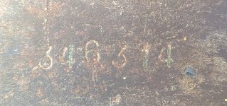

Unable to see much info on this. The wheels are 12" x 2"
Whole thing probably weighs 350-500 lbs.
It has a solid brass nameplate.
Says
Powermatic Heavy Duty Grinder
McMinnville, TN.
HP 2 RPM 1750
Can you tell me more motor specifics? Date of manufacture?
I don't have 3 phase power, so I need to set up a Variable Frequency Drive, but not sure if they can handle the inertia load back into the system, after powerdown. thank you for your help.

Here is 2 HP Powermatic in the link below. Powermatic is made by Baldor. There's a few other Powermatic bench grinders on this page.
Photo Index - Powermatic Machine Co. - 1217W Powermatic 2HP Bench Grinder | VintageMachinery.org http://vintagemachinery.org/photoindex/detail.aspx?id=41449

I believe I have that same grinder.
I added a photo of the tag if that helps.
My guess is it's closer to 300 lbs.
Mine came from a high school and had all that safety stop and electronic braking **** on it.
I took it all off and installed a simple AB starter.
I run mine off a rotary phase converter as I have several other 3 ph machines in my shop.

Here's a couple more photos of when I got it. That dynamic braking system required two 12x12x6" enclosures to contain it all that they had scabbed on it everywhere and with that "short bus" off switch ruined the looks of the old thing.
The brake did work tho. Before I took all that stuff off I did an experiment. I ran it up to speed then hit the big stop button. It took 16 seconds to come to a full stop.
Then I ran it up to full speed and unplugged it from the wall. It took 1 minute and 46 seconds to spool down to full stop.
I just watched it and smiled :)

The inertia formula uses rotating mass. I calculate each grinding wheel at 21 lbs each. Since it is a 220v - 3 phase - 2hp motor... it should be about 1492 watts (746 x 2). I am going to use a 2.2kw braking resistor, which needs to stop that mass in 15 seconds. I don't want to toast the vfd in the very first use.
