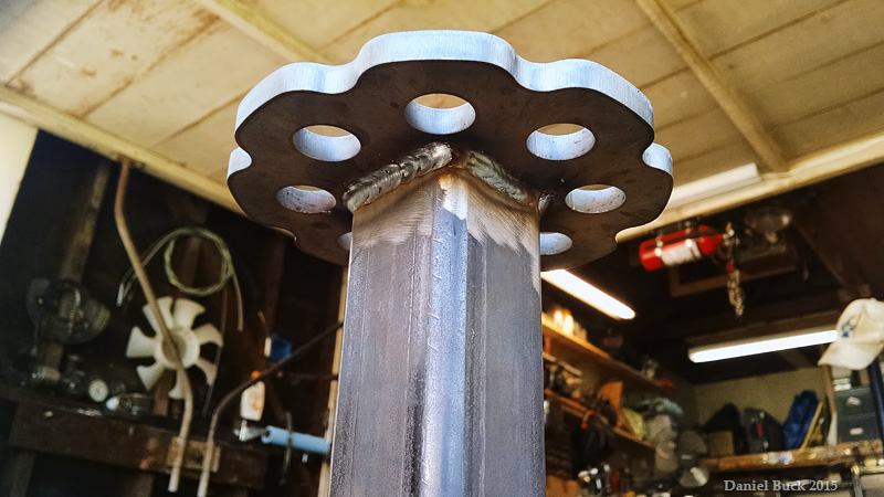

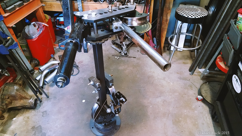

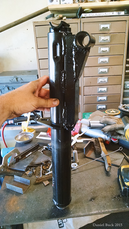

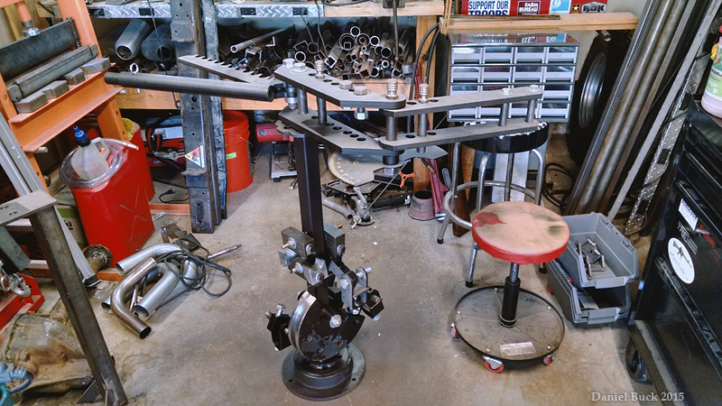

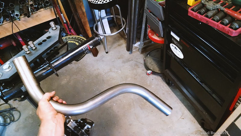

danielbuck
Apr 15, 2014
919
A while back I made a new stand for my tube bender, then removed the handle and replaced it with a trailer jack:
Great job on the fab and welding. Just for future reference, welding mild steel to drums and disks tends to be problematic as the weld tends to crack at the boundary. With the hydraulic it won't be near an issue as if you were manually bending but just something to keep an eye on.

danielbuck
Apr 15, 2014
919
I did heat up the disk before I welded to it, I don't know if that helped or not. I did the same thing when I welded a stand out of a flywheel, torched the flywheel until it was good and warm before welding to it.
It's still mechanical (you put a drill to the end of the jack) but I haven't even bolted it down yet, it doesn't move while bending.
