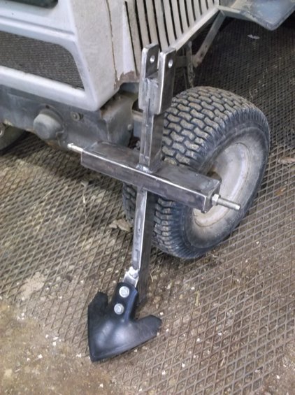

Whipped up this little subsoiler for my father's garden tractor.
Intentions are to use it to break up the ground a bit before hooking up the tiller to the garden tractor.
It's only 23 horse, so I don't know how deep I can get it to pull. May have to narrow the width of the blade some, too.
Used about 8' of 1/2"x2" scrap steel that got a few bends.
I'll be making a much larger one this fall for his tractor. He's been borrowing a single shank that rips down about 20" deep and is wanting a 2 shank subsoiler to get done a bit quicker.
Have a 1" thick plate 42"x42" I plan to use for it.

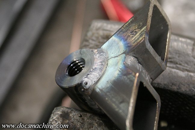

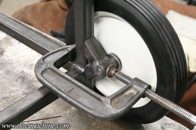

Just picked up a Wilmont 2x72" belt grinder, and made a mobile stand for it. I don't really have a room I can keep grinders in, so while a shop-vac and a spark-catcher will work for small jobs, for extensive grinding, I plan to be able to roll it outside.
So I made this stand for it:
It works like a hand truck, you tilt it towards you, and roll it around on the two wheels, then set it back upright. None of my floors are terribly level, and I wanted it to be fairly stable even outside, so I designed it with three "feet" rather than four.
I made these little doodads to hold the wheels...
And they attached like so:
I haven't painted it yet, as I'm going to wait 'til I have a bigger collection of contact wheels and tooling arms. At that point I'll make a "rack" of some sort underneath to hold them (in some way where they won't slide out and squish my toes :D ) and then paint it.

Doc, what saw are you using to cut the square stock for the wheel mounts? It appears you're getting some nice, repeatable cuts.

That makes more sense; I was wondering what kind of saw could clamp on such a small piece of material and still make an angle cut. :lol_hitti
You could do those pieces in a chop saw too. Start with your first angle then rotate the piece 180 degrees in the vise and make the second cut and you’ve got a small piece with opposing angles.

I agree, but I've yet to see a chop saw that will clamp and cut such a short length.
My whole inquiry is because I just ordered a HEM 782XL bandsaw, and those cuts looked like they were made by a bandsaw blade, but I don't think the HEM saw I ordered would've been able to make those cuts for the above stated reason. It never dawned on me that it was done on a vertical bandsaw.

You might be missing the point he's trying to make. You can cut those pieces from a long piece of material. Clamp the long piece, cut one angle at the end, slide the material 3 inches or so, then rotate the whole piece or just change the angle of the blade. You would still have plenty of material in the vise.

Just a little ole Doall vertical saw! LOL One of my friends has one, sure is a beast of a saw. Makes my Ellis look like a toy. :)

That’s exactly how you do it, or how I do it when needed.
