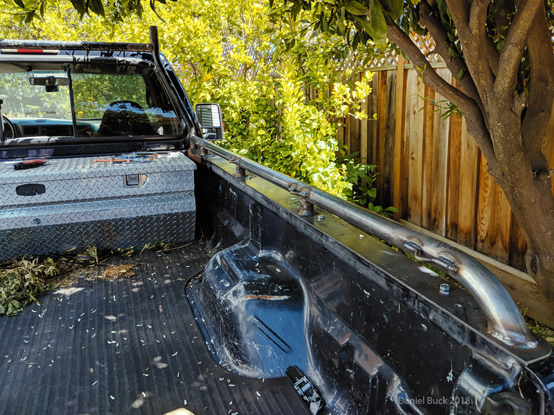

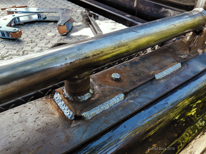

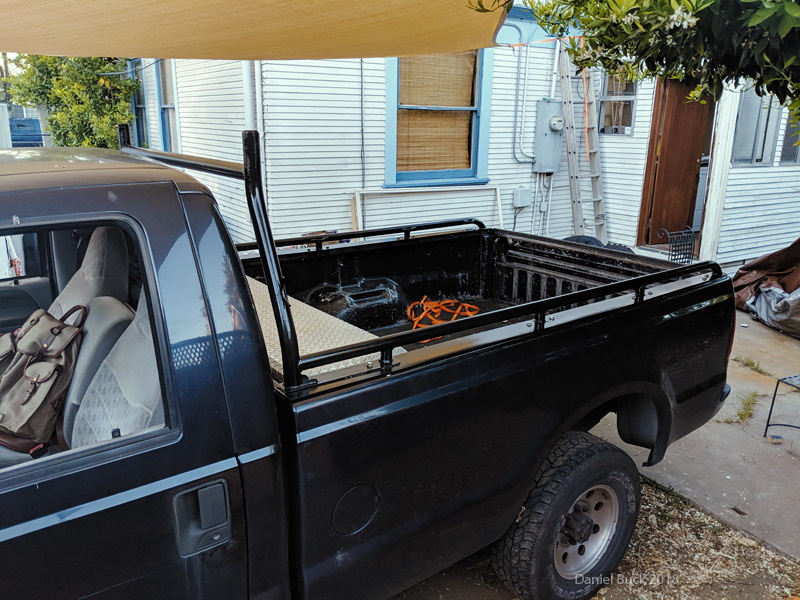

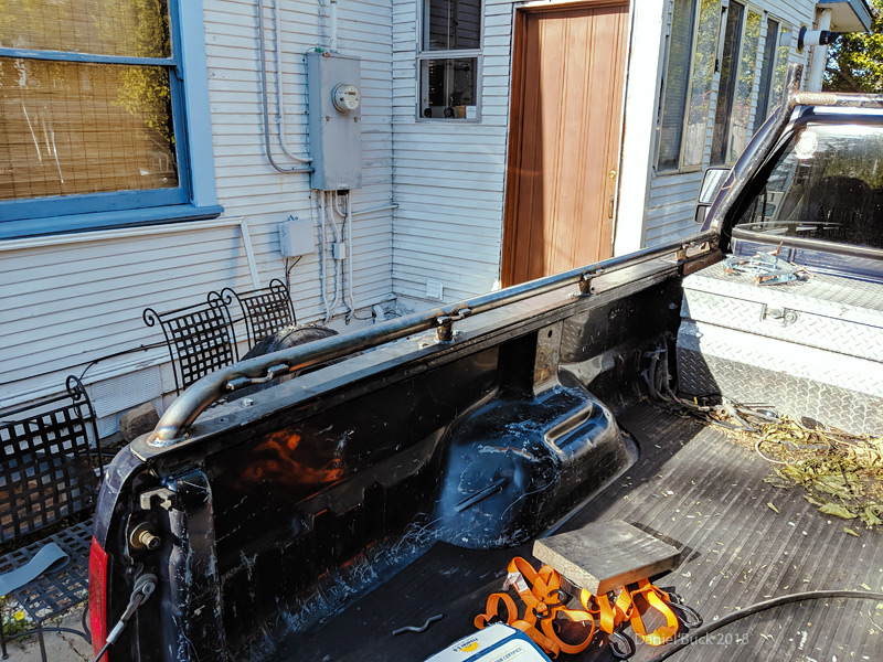

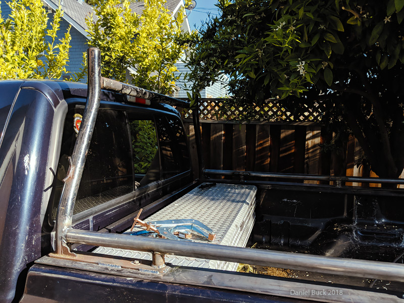

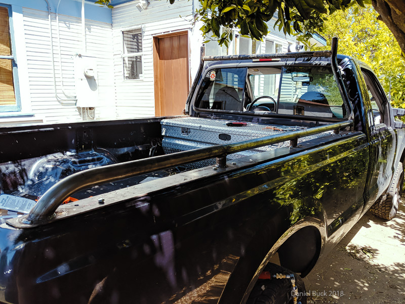

made some bed rails for my truck. The up-right bars behind the cab were there when I purchased the truck, I just made the rails on top of the bed sides.
Flat bar is 3/16", tubing is 1.75" .120 wall HREW
danielbuck
Apr 15, 2014
943
Those looks awesome! Having the extra tie down points will also be really nice.
that was the main reason for doing this, and also just because I like the look of side rails.
I got the truck to help me move, and I quickly realized that there are NO tie downs except for in the bottom corners of the bed, and the tool box makes the front corner hooks pretty much unusable.
2 hooks for the entire bed.... great job Ford. :lol_hitti

I always wished they had done a set of tie downs on the wheel wells. Even with bed rails it ***** not having good, low tie down points.
ndr1968
Apr 18, 2012
207
Oklahoma
A truck bed without rails is only good for hauling air or maybe trash if the sides are staked up high.
