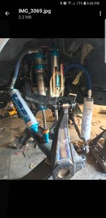

Front long travel kit I build for 95 - 04 tacoma. Gonna be making a 4x4 kit here soon hopefully.4d055ee3fab2dbbd949dfe9ac2ef47bc.jpg
Good gawd, you do some nice work TT.
Something about a long travel suspension that makes my jeans tight.
I'd love something like that for my Tahoe. Just don't know where to go with my rear set up. I need to move my tank and then I'd have all the room in the world.
What would you suggest for a rear set up on an SUV? JD Fab did a wild leaf set on a NBS Tahoe that was pretty creative. He used leaf springs instead of links/arms.
Don't waste your time or money building a Tahoe. To make it work half way decent you're looking at BIG money. You would be money ahead buying a SxS or starting with a Ranger/Tacoma. If going for looks, anything works.

What gage plate are you using on the suspension arms? Is it 4140 or mild steel? Parts look great.
