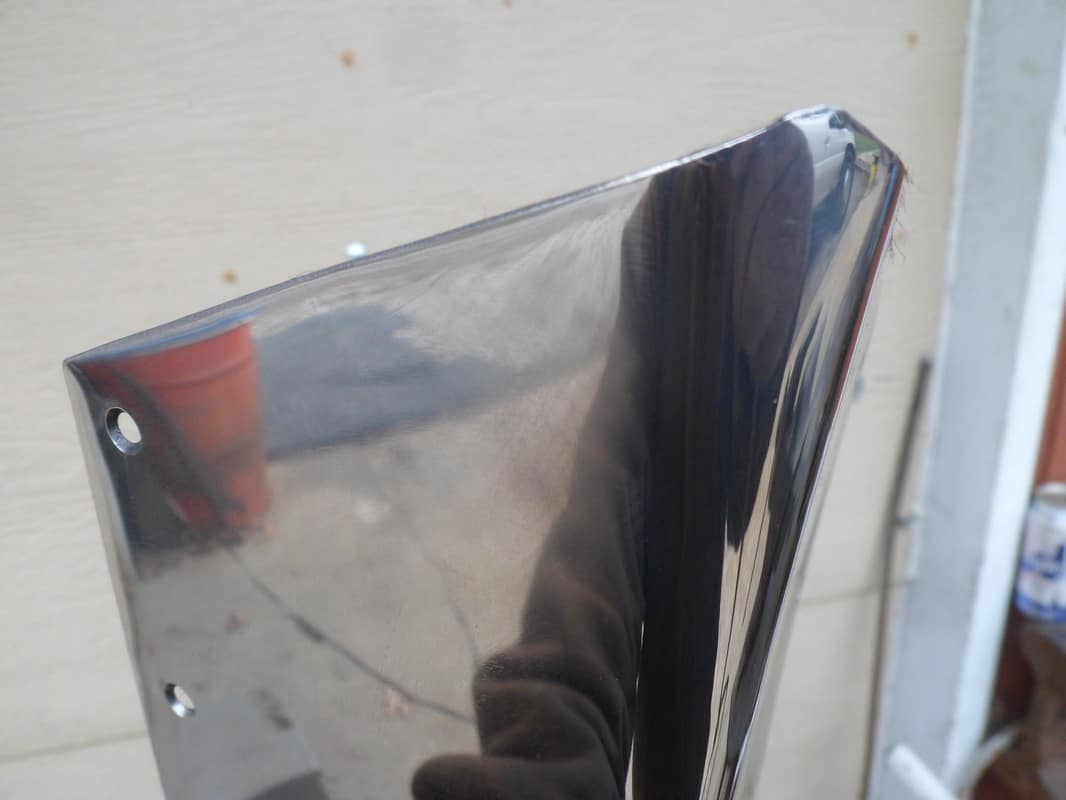

Finished product, Boat "Cutwater" = 2 pieces 18 gauge 304 (2b finish) sheared, machined, drilled, welded, machined again, buffed, boxed, then shipped.
The process, shearing halves close to cardboard pattern (from customer) as possible using beverly b3.
pieces clamped together with pattern in between for grinding to size.
grinding sandwiched pieces.
both halves exacto to each other, deburred, holes drilled, contersunk and deburred.
halves tacked together to maintain opening dimension marked on pattern.
nasty looking overfilled weld, opening dimension maintained as per pattern. (theres a reason for overfilling)
Self taught backyard welder (metalmelter) 55years, using tig building 100% of these 40 years, nothing sent out. thanks 4 looking.

Nice work, what's the reason for overfilling?
With a angle grinder, overfill is there to provide a visual surface to take down as close as EYEBALL possible to the base metal. Its not good touching the stone to the basemetal. When its taken down as i need i take 240 grit sander and blend whats left of the bead into the plane of the basemetal. Then i go 400 grit then 600 grit. Buffing and the above is the most tedious part of the job.

Heres the 1 i pictured last nite. (lower 1) The excess weld taken off/down to base metal using angle grinder then 240 grit sander. The closer 1 pictured has been split to repair damaged areas (deep dents) just aft of the welded point. This 1 is original to customers 1947 chris craft and worth restoring.
