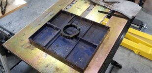

Ok, intimidated by the artistry and perfection in this thread, I’m gonna show my little project any way.
While I have a perfectly good in-ground MC lift in the attached garage, said lift is currently covered up with all the things related to a bathroom remodel. The Ultra has an issue and I wanted to put it on the lift so I used this as the excuse to finally build an adapter to put it on the two-post in the shop.
The bike is quite low to the ground and it became a challenge to make something flat, thin and strong enough.
I started building something with angle but it quickly became obvious that it would be way too tall to work.
I started over with 1/2” plate, a big bolt and tried to “low profile” it.
A test fit before adding bracing
Also had to check the flex without the extra bracing... just had to know, ya know?
Way too much flex.
I decided that the footprint needed to be larger (adapter to lift arm) for stability so I reattached part of the dropped piece and the added the 3/4 stock that I was planning.
No flex, much more stable.
Cleaned it up a bit.
It’s actually way more stable than expected, even on the long arm.
I’ll only use it on the short arms anyway.
