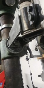

Picked up an import floor standing drill press with a custom table for cheap at an auction, and the table in a separate lot.
After bringing it home, I realized that the custom table wasn't flat in any direction. It was sloped down and twisted. I screwed a piece of wood with wedges to manage for a bit, but decided to fab up a new knuckle.
Took a piece of pipe and cut out the middle. Made some tabs to clamp onto the existing table mount. Turned down a piece of pine on my wood lathe and drilled a hole to be a solid jig to make it square to the chuck.
Made some arms, and a piece of angle to mount to the pillar, and tacked it up and welded it out.
Amazingly, it was as square as I need it once I mounted the table and locked it all down.

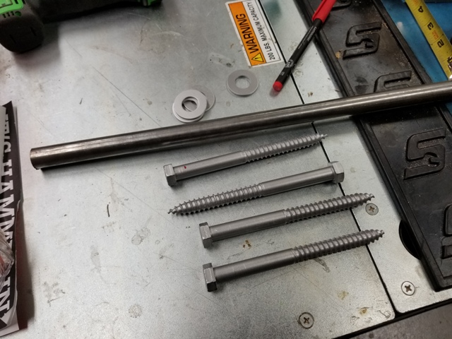

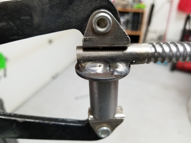

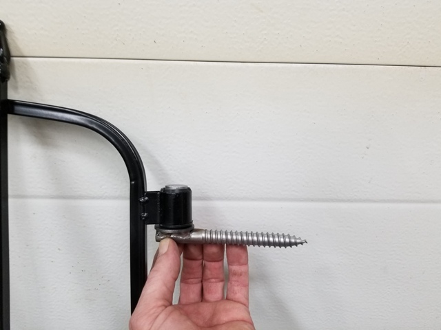

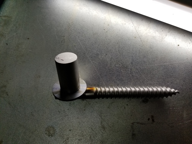

Little project for my Dad's neighbor. He was helping them hang two gates, but couldn't find hinges that would work the way he wanted. I came up with these,
