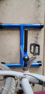

I threw this together after work the other day. I got tired of having our bikes leaning on **** in the garage, getting knocked over, etc. I had the rubber feet and top cap leftover from another project, so I ran down to the metal supply and got a $17, 5' stick of 1.50", .095" DOM. Why DOM for a bike rack? Well, the supplier has DOM precuts, so it's cheaper than buying a full stick of welded or paying the cut fee to get a partial. The spuds are .750" .120" I think (scrap pieces). Had it powdercoated to match the blue HF service cart I use for my bike tools.
For those that aren't up to speed on the latest bike standards, most mountain bikes have a 20mm hollow bottom bracket spindle that the crank arms attach to. The spuds (slightly angled upwards) are inserted into the bottom bracket spindle, which lifts the back tire off the ground. It's super stable with zero worries of knocking the bikes off. Here is the commercial version that I got the idea from: https://www.etrailer.com/Bike-Repair-Stands/Feedback-Sports/301-17300.html
Not a masterpiece of fabrication, but it's brought organization and sanity to my life!:lol_hitti
