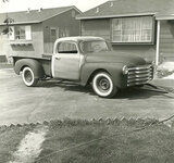

Joe, every time Gene Winfield opens his mouth, pearls of wisdom come out. From "Every day is a School Day" to "I'm just getting started." First time I came across Gene Winfield was in 1956 when he did some work on Spencer Murray's Rod&Custom Dream Truck. Readers wrote to the magazine, suggesting changes to the truck and every issue of R&C contained a story about the progress. Started out as a 1950 half-ton Chevy pickup with one of the first small block's from GM in 1954.
The truck visited all the legendary Southern California hot rod and custom car shops. Sam Gates chopped the top and sectioned the body and then Gene radiused the front wheel wells and sectioned the hood.
Then the truck went to Barris for more bodywork and Dean Jeffries for paint. The magazine even showed how to reverse the wheels and then send them out for chrome plating and put some fancy bullets on the hub and lug nuts.
Customizers sure loved purple back then.
The truck was wrecked in 1958 on a tour but 20 years later it was restored, The whole Dream Truck story is here: https://kustomrama.com/wiki/Rod_&_Custom_Magazine's_Dream_Truck
