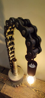

Todays project; a lamp for the hall table i made last week. Different parts from the scrap pile, a bit of cleaning and a new cable for the bulb. Weighs enough.. :D
This is one of the coolest lamps I've seen - what's the gear from?
Thanks, turned out way better than i expected. Actually no idea, i visited a long time ago abandoned factory, those were left laying there so i grabbed them with me. Lots of stuff going to trash eventually, maybe i gave them a new life? :D
