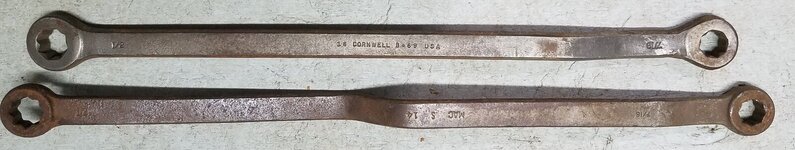

Here is a photo of the progression of these offsets, with later Cornwell and MAC tools for example.
Here is a photo showing the difference in offsets of the two later wrenches. Also note the difference in length. I have positioned them so the opening sizes match. It appears that there was no common pattern for these.

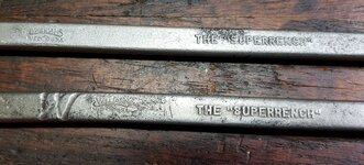

Here are a pair of Orwellian Williams Superrenches I have. Both Chro-Molys. One is a No. 1984 (4-point), as advertised in the 1931 catalog, the other is a No. 1984X (8-point), which shows up in the 1939 catalog.

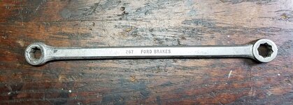

#267 Ford Brakes as posted by Lugz
