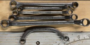

Last week (Wednesday), I chanced upon a Cross Country DBE, but was uncertain if it was a dupe to me, or not. I could not find any notes on my phone about ones I KNEW I owned. I put it with some Bonney and Craftsman tappet wrenches and offered half her asking price. The lady selling listened to my story about the CC, and counteroffered to toss it in with the others (at her price) as a bonus, which I accepted.
Got back to my stash this morning, and it is NOT a dupe. It seems I have not previously posted these on this thread, so here:
Chrome Vanadium Steel DBEs
- straight 25/32x11/16
- offset 7/16x3/8, 9/16x1/2, 11/16x5/8, 7/8x13/16
- moon 5/8x9/16

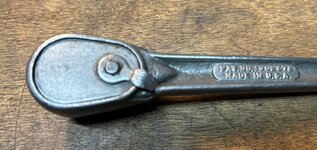

I had one of the WW2 tool kit forged flat reversible 1/2" ratchet drives for years ......no identification at all ..........I found a tiny patent no. on it,that ID s it as a Duro.........Grey finish ,may be zinc ,or zinc paint..........never seen another duro tool here .
16,675
Even though the patent was a Duro patent, the unbranded ratchets are actually very likely to be Indestro ratchets later marked No.3202R. They are slightly shorter than the Duro-Chrome marked version. During WW2 the separation of Indestro and Duro was not particularly followed with examples of both brands appearing together in sets.IMG_2846.jpeg

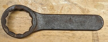

Here is another item from the Shop Clean out, round 2.
Duro Chrome No 281 - USA wrench. 8-3/4" long, 1-1/2# 2" opening Drain Plug Wrench for Ford V8-85 and Mercury A full forged steel 2" 12 Point Box type Wrench heat treated, tempered, triple plated with polished ends. Fits Ford "V8-85" and Mercury Cars. $2 in 1939 catalog.
Slight bend up into the picture at the start of the shaft / ring transition. More obvious in the catalog.
Per another site: Ford Model 48 (V8-85) (1935-1940)
Don't imagine this will see too much work around here, so if someone needs it for your Ford drain plug, gimme a holler.
Catalog cut here

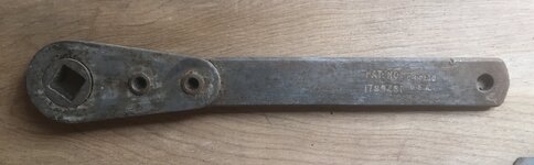

So I've got an old Duro 3/8" rat that's all locked up. I've soaked it in Kroil for days but I think the pawl might be jammed or something. The selector lever won't move and neither will the anvil. It looks like I'd have to pry the selector lever off to get the thing open but I'm worried that I'll damage the lever/and or not be able to reset it. Any advice? I know this isn't a repair thread but I figured someone must have taken one of these apart before...thanks!
saukit
May 29, 2021
574
It’s been in the Evaporust bath two or three times now…plus the Kroil, also put it in the vise to free the anvil, and finally tried to gently hammer the selector switch loose. It’s locked up solid. Maybe I’ll just have to force it a bit in the vise but I’m gonna be pissed at myself if I break it!
