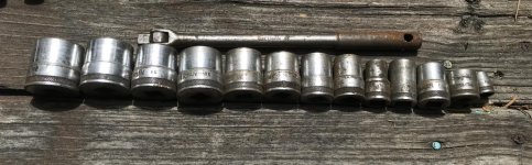

16,655
I found quite a few long C tools at the flea on Saturday. All of the sockets are BE, I believe. The 3/8” drive circle H flex handle cleaned up pretty well.
