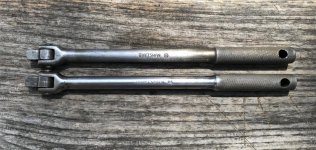

I recently acquired this Craftsman C-97 1/2" drive ratchet from D42jeep to go along with the rest of my Craftsman C-series tools.
Also of interest is the two styles of C-93 breaker bars. The top one came with the socket set and the one below it came from Smokeshow a couple years ago. Do I guess correctly when I say those are the result of a patent lawsuit between Snap-on and Plomb?
The ratchet makes the rest of the set look like ****. Now I need to upgrade ...
