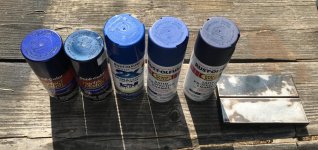

I bought several cans of dark blue paint to use as a topcoat on the larger 1/4” drive BE box that I received from JoCo. Fortunately, the paint I picked dried much darker than it went on. The final color is hard to see in pictures even when using the flash. Now I just need to install the decal.
Boy that looks really nice! Thanks for the tip on the paint color match as well
