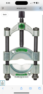

Small bearing puller needed

"What manual / catalog are those tools out of? If my lathe was powered up I’d make one and add two bolts to pill it together however it’s not getting wired up till I get into my new shop with 3PH and that buildings not going to ready till January at least."
Grant
As a factory Service Centre for most brands of tools, we have access to many specialty tools that are designed and made to make fixing their tools easier. This plate set is from one of those, so not something that is commercially available.
Personally, I prefer to press bearings off, rather than pull them off, although we have an extensive selection of pullers and press fixtures.
This is the bearing splitter that I use regularly, similar to the Kukko you have shown.

The beam part of the puller sits in the box, just use the knives

Have you considered just boring a hole the same size as the outer race into a piece of 1/2” strap steel maybe 4” wide similar to your bearing splitter? Then you could simply tack weld the outer race to the strap and then easily press the bearing off the shaft. Touch the tack welds with your angle grinder, hit the old bearing out with a punch and you’re ready to pull another bearing off. If the outer races are different diameter just bore more holes in the plate. I think my description takes longer than doing it. Just a suggestion, and minimal cost to try.

I may be missing something, but if you already have a puller but the tips are too thick; with such small diameter bearings - ever thought about filing/grinding a taper on the tips; use a vise grip pliers with pipe jaws to hold the tips tight to the bearing.
Can't tell the bottom clearance from the pic's; feeler gauge should do it - guide you in modifying your puller.

If the puller you found from Forza doesn't get there, look up the Schrem pullers from JRM. They can grab the inner race and pull the bearing off the shaft that way. You would need 3 parts: Puller, Collet, and the forcing screw point (aka spindle adapter).
Those look awe fully beefy. Wish I had known about their collet pullers. The tool I modified is working well, but the Forza will be a nice back up.

Ordered a bunch of pullers. We will see what works after it all gets delivered, but I’m not too optimistic on any them.
Have run into "sunken" bearings such as this many times. What I do is chuck up a piece of tube or pipe of right OD (less then ID of recess in gear) and ID enough to leave a workable diameter and "lip") then machine a bearing OD and width (22 x 7 mm in this case) on one end with a tapered lip at end ID maxed out of 0.8mm at the root tapering to near zero at the ID. Make a similar ID groove at the other end, but with more and square lip. Make a round nut to use a grade 8 UNF puller bolt. The nut goes into the square groove at the outer end, the bearing will fit the inner groove at the bottom end. Cut the tube longitudinally with band saw into 4 x 90 degree parts, each of one will now easily fit into the counterbore and hook behind the bearing. Now that your puller "hooks" are over 2" long, you don't ultra hard tool steel or a really think hook to be able to pull the bearing. The puller nut goes into the top groove and you clamp the whole thing together with a normal gear type hose clamp. The will give enough friction to hold the puller nut from turning while you run the gr8 bolt in to pull stuff off. I have removed some extremely tight bearings with such a tool and it takes only a half hour on the lathe, no waiting on orders, material from offcut scrap pile.
If this is to be a very high use tool, I would make the OD with a taper to be able to slide a tapered ID ring over the outsie to clamp it all together instead of a gear clamp.

Here's my offering, but you'd still have to grind it down a bit. The 2.5mm seems to be at the thickest point of the finger, the thinnest part of that finger is thiner than the base, butnit appears to taper upwards from the base. These are plenty stong in unmodified form for windshield wipers, abut I don't know how weak it would be if you shaved it down.
