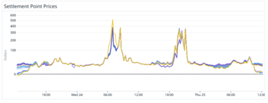

It's remarkable to me how much the wholesale power market swings here in TX...I think being able to predict and optimize likely can result in some real advantages... Now just think how cool it would be if we could store this power during "low price" settlement points and distribute it when the market is demanding much higher prices... But on a regional level.

Well, sure.. I mean that makes sense to me. But like any business, they're going to get margin somewhere and if they can't "optimize" to the margin, they'll get it on the other end with a price increase to consumers. I'm in a co-op, so what's better for the business is technically better for me as a member... I'll ignore the prior lavish spending by the board on trips to vegas.
that's part of the issue with flat rate billing. residential tier one here is an "average" of peak and off-peak power. is that fair to anyone? to small users it's probably just easier accounting, but a lot of the time people are paying 50% more than they need to.
there' another side effect though. I think it incentivizes bad behavior. Say you know that certain hours are "peak" and it costs more to run big stuff (like your dryer) during that time. but you're on the flat rate so "it doesn't cost ME any extra, **** it time to turn it all on!" well if lots of people do that, it ends up costing EVERYONE more, driving up the base rate.
with analog meters, it used to be that you could get a second "cheap" meter for off-peak water heaters, but they just put a timer on it so it was off outside of certain hours. then if the power went out the clock was wrong and had to be re-set. or you have a meter that can log different time periods, but that doesn't scale well, and it's not very flexible, and then the customer needs a timer that they ALSO have to maintain.
smart meters and appliances that buffer energy (like water heaters, or the "new" thermal storage wax/brick systems), allow everyone to benefit from accurate billing, and being able to load shift to cheaper times benefits both the end user and the grid, and thus other customers.
is that just more margin for the utility? there may be some in there for them, but I don't think it's a pure profit play. that's not the system we have, it isn't that simple.
