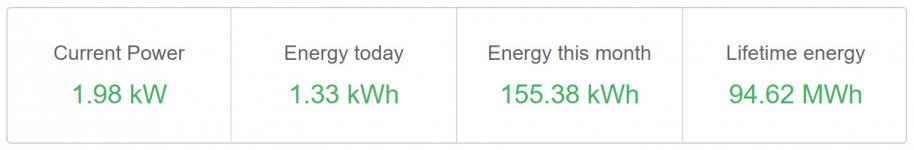

I took the leap, did a 9.5kw grid-tied (net-metered) system. Up here in New England we pay big for power, so offsetting our utility bill is quite attractive.
I used a local contractor for all of it, I sipped coffee and watched them do the work...lol. The SE facing roof plane of my barn is almost perfect for solar. The contractor maps all this out, and it is part of their calculations. I have one tree that throws a tiny bit of shade at first light, but then it’s full-on sun (on a sunny day).
I am on month 4 with the system on-line. The billing cycle for my power is mid-month to mid-month. My first “full billing cycle” was Feb-March. I would typically be running a $150-$175 electric bill. I got a $84.44 credit bill for that period. So I not only offset my usage, I generated well beyond, and that is during the terrible winter solar arc and short days!
Now, on a mixed day (partly cloudy) I fully offset my consumption, plus a little. But on a full-sun day my system does 5-7x my consumption.
My whole system is by Enphase, a big name is solar. Panels, micro-inverters, combiner/controller/optimizer. I had one bad inverter from the start, the contractor swapped it out, all good now. The app works great, live data and historical data. It graphs Generated/Consumed/Imported/Exported.
Here is a shot of yesterday’s (4/2/2021 in Seabrook NH) information. Mind you, we had a partly cloudy day on the seacoast, which is why you see the toothy graph.
My best generating day was just shy of 70kwh, and that was in March!
In the end, I am no “tree hugger”. I’m a conservative that chooses to use part of my financial resources to power and heat my home for the betterment of the planet and environment (I heat mostly with pellets, but I do have a traditional hydronic system fired by oil). I think for most the case cannot be built solely on financial return. My case is favorable, but even still struggles to prove an aggressive return. In the end, I see it as me offsetting my usage, though I still need the grid at night/bad weather days. I’ll be watching battery tech to improve, and consider adding them if things get to a manageable price point.
My system: $23,800 all-in.
